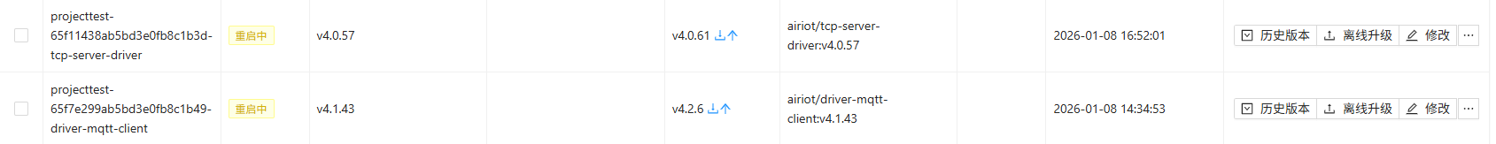

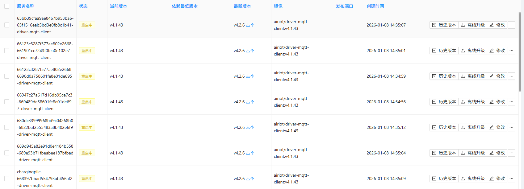

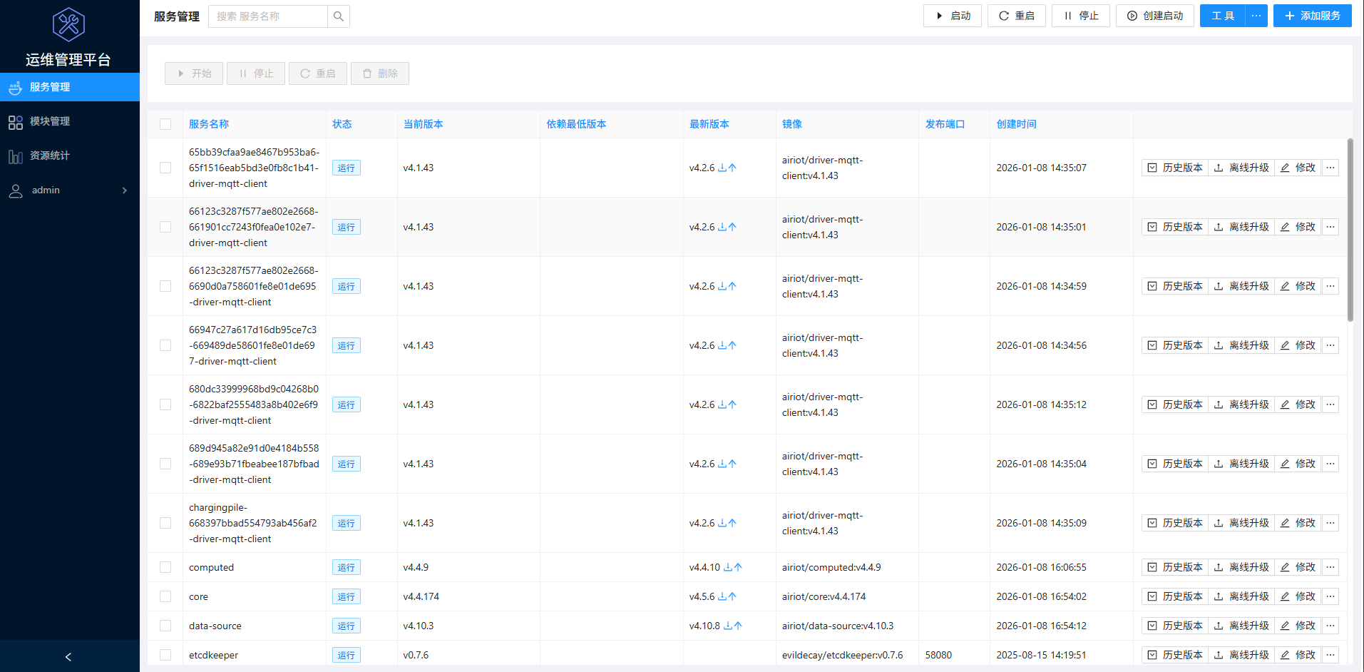

    lihuan
    重启后这几个一直起不来

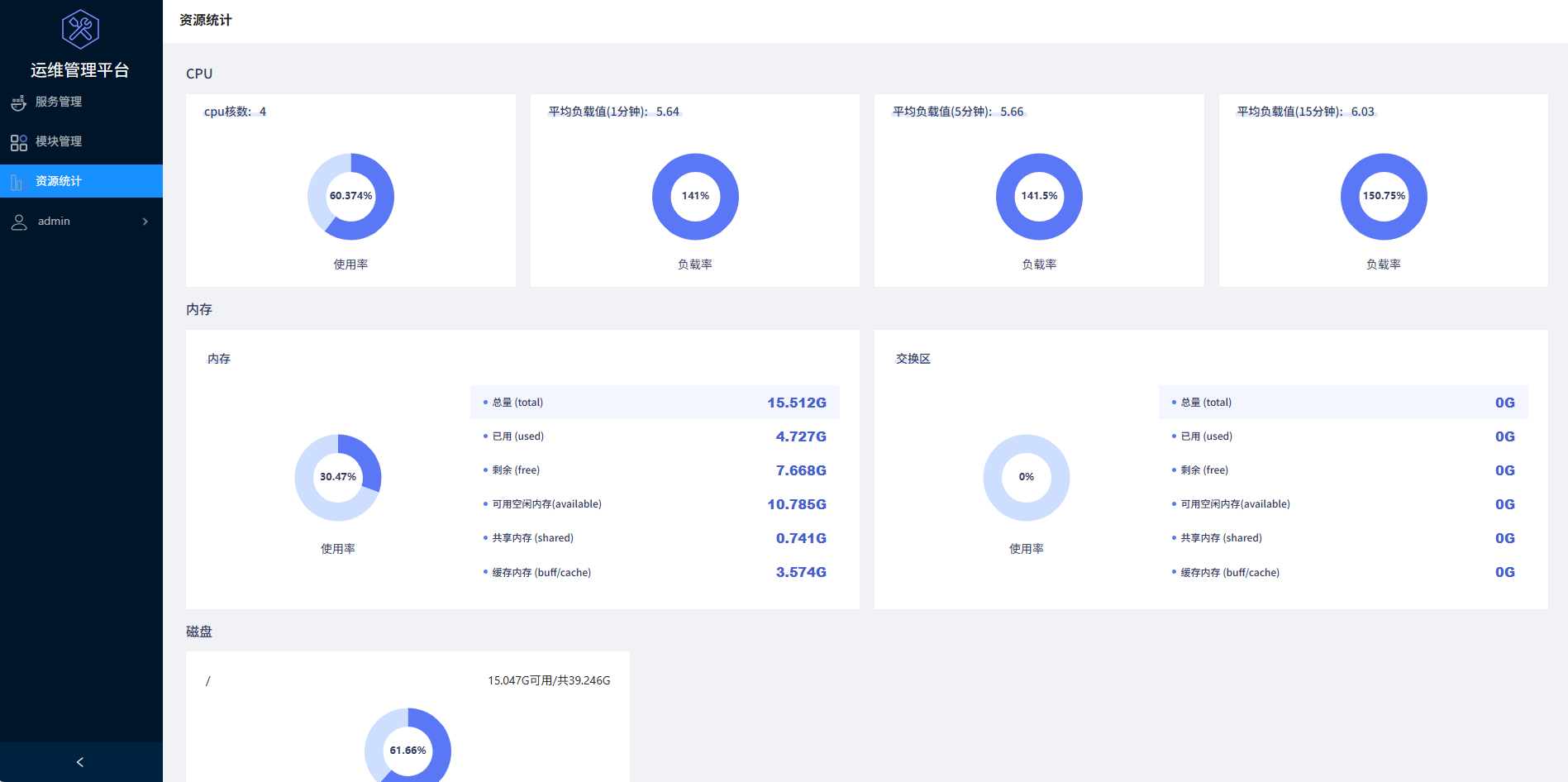

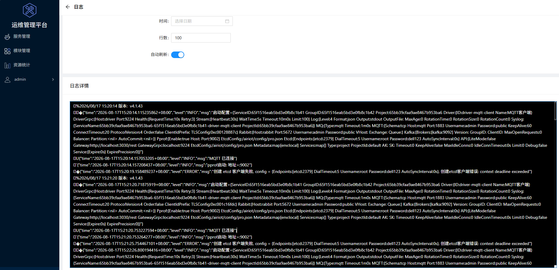

    image.png看一下这个日志,另外运维管理里资源统计页面截个图
  • L 离线
    L 离线
    lihuan

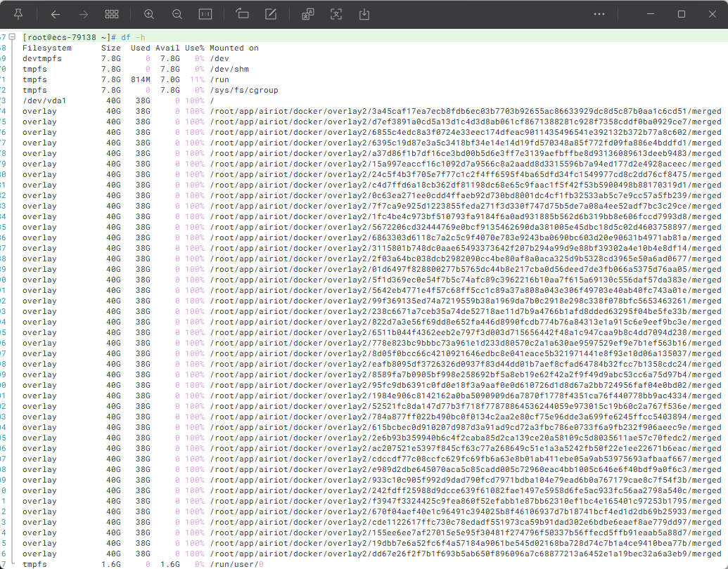

    我磁盘清理了十四g

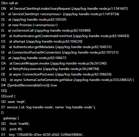

    lihuan
     for call at
    N at ServiceClientImpl.makeUnaryRequest (/app/log-handle-node.js:1:1341607)
    I at ServiceClientImpl.<anonymous> (/app/log-handle-node.js:1:1419734)
    ) at /app/log-handle-node.js:82:103505
    ! at new Promise (<anonymous>)
    : at runServiceCall (/app/log-handle-node.js:82:103480)
    P at Authenticator.getCredentialsFromHost (/app/log-handle-node.js:82:104583)
    3 at attempt (/app/log-handle-node.js:82:104220)
    E at Authenticator.getMetadata (/app/log-handle-node.js:82:104531)
    I at ConnectionPool.withConnection (/app/log-handle-node.js:82:107251)
    ) at /app/log-handle-node.js:82:106672
    A at ExecuteWrapper.invoke (/app/log-handle-node.js:56:261240)
    ? at RetryPolicy.execute (/app/log-handle-node.js:56:248794)
    E at async ConnectionPool.exec (/app/log-handle-node.js:82:106630)
    Q at async SchemaCacheGenerate.getValue (/app/log-handle-node.js:333:248632) {
    # [Symbol(RecoverableError)]: true
    conf: {
     save: 'mqtt',
    ? service: { id: 'log-handle-node', name: 'log-handle-node' },
    gateway: {
     host: 'traefik',
     port: 80,
    1 key: '138dd03b-d3ee-4230-d3d2-520feb580bfe',
    3 secret: '138dd03b-d3ee-4230-d3d2-520feb580bfd'
     api: {
    # endpoint: 'http://traefik:80',
     type: 'tenant',
    0 ak: '138dd03b-d3ee-4230-d3d2-520feb580bfe',
    / sk: '138dd03b-d3ee-4230-d3d2-520feb580bfd'
    etcd: {
     endpoints: 'etcd:2379',
     dialTimeout: 10,
     username: 'root',
     password: 'dell123'
    mqtt: {
     host: 'mqtt',
     port: 1883,
     protocol: 'mqtt',
     username: 'admin',
     password: 'public'
    Q rabbit: { host: 'rabbit', port: 5672, username: 'admin', password: 'public' },
     log: { level: 'warn' },
     _: [],
    % configs: [ '/app/.productionrc' ],
     config: '/app/.productionrc'
    getValue in:
    oError reading from etcd: GRPCUnavailableError: 14 UNAVAILABLE: Name resolution failed for target dns:etcd:2379
    ? at callErrorFromStatus (/app/log-handle-node.js:1:1312618)
    B at Object.onReceiveStatus (/app/log-handle-node.js:1:1342108)
    B at Object.onReceiveStatus (/app/log-handle-node.js:1:1337596)
    B at Object.onReceiveStatus (/app/log-handle-node.js:1:1336918)
    ) at /app/log-handle-node.js:1:1435981
    S at process.processTicksAndRejections (node:internal/process/task_queues:77:11)
     for call at
    VGRPCUnavailableError: 14 UNAVAILABLE: Name resolution failed for target dns:etcd:2379
     for call at

    docker ps | grep etcd 看下etcd运行了吗,再看下mqtt日志
  • L 离线
    L 离线
    lihuan
    mqtt日志:

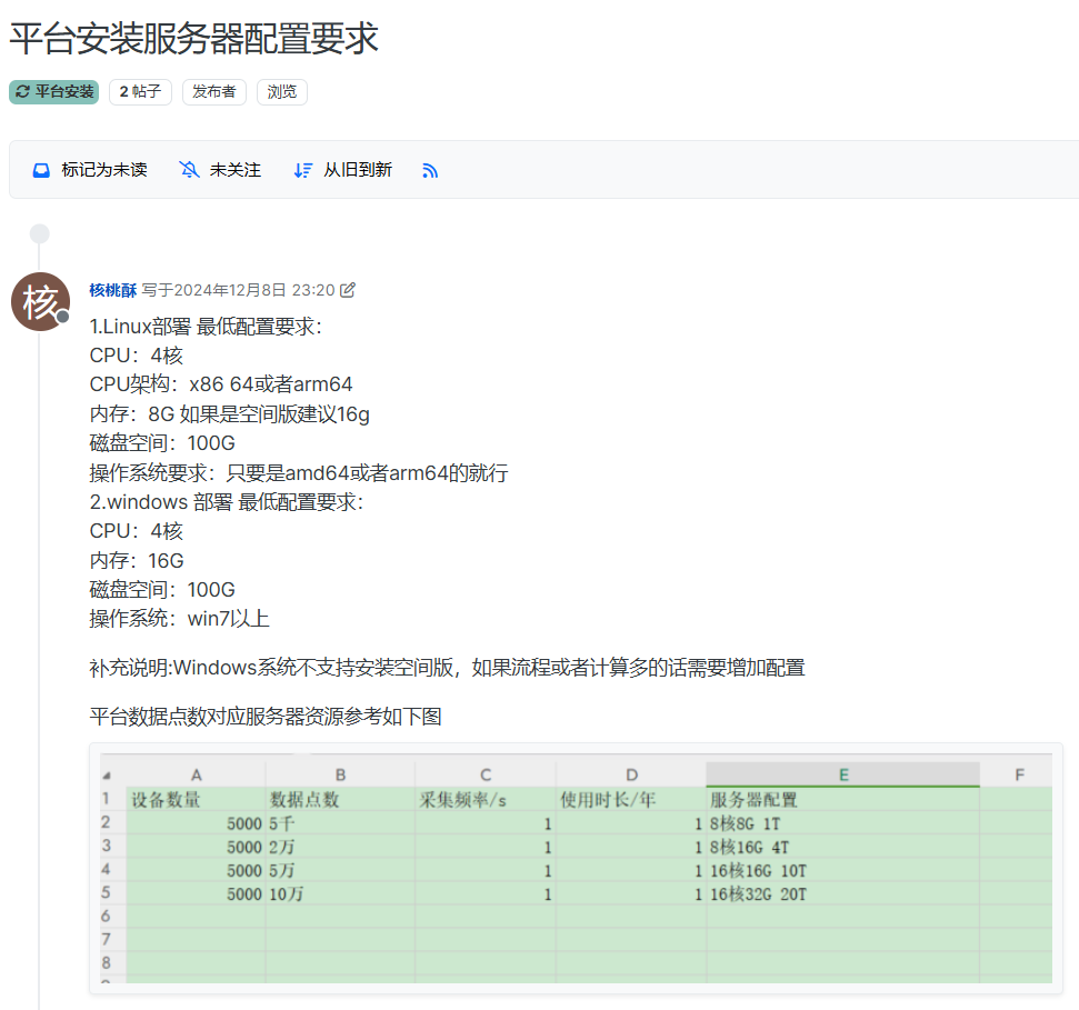

    您这个项目用多久了,50个g太少了,我们平台要求最低100g

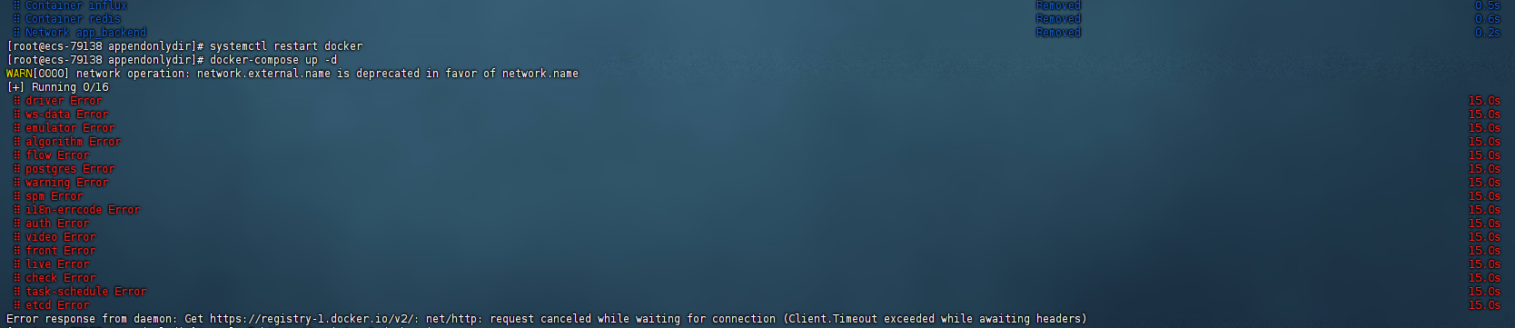

    您刚才重启都执行了什么
  • L 离线
    L 离线
    lihuan
    systemctl restart docker
  • L 离线
    L 离线
    lihuan
    /root/app/airiot/db/redisdb/appendonlydir
    将这里面的内容删了,重启了redis
  • hpH 离线
    hpH 离线
    hp
    docker-compose down
    docker-compose up -d
    试试这样

    但是这个磁盘空间小运行肯定得有问题,我们平台最低配置就是100g 之前能运行后期数据多了就没法保证,得保证满足最低配置才能稳定运行

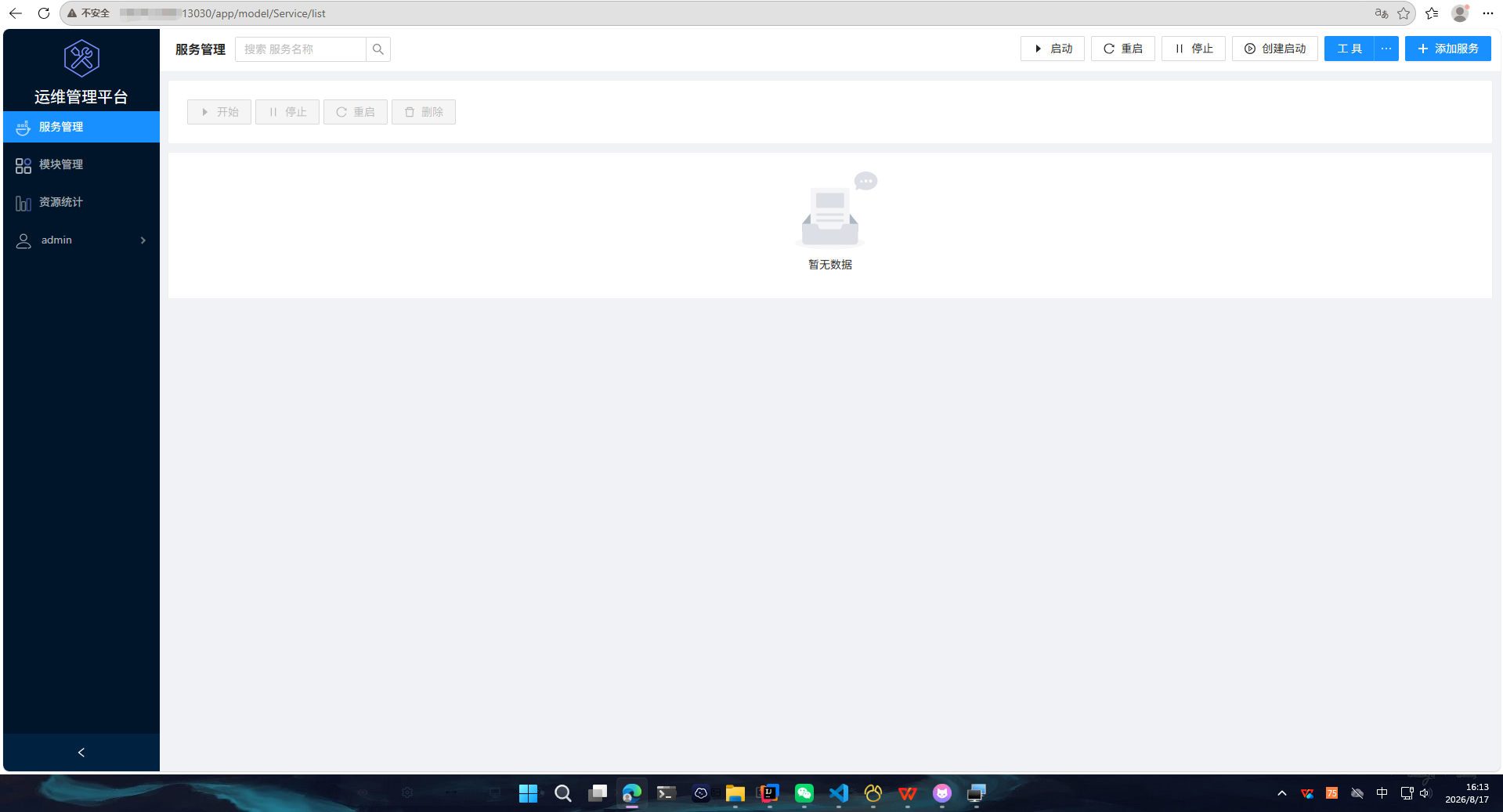

  • L 离线
    L 离线
    lihuan
    现在连一个服务都看不到了
