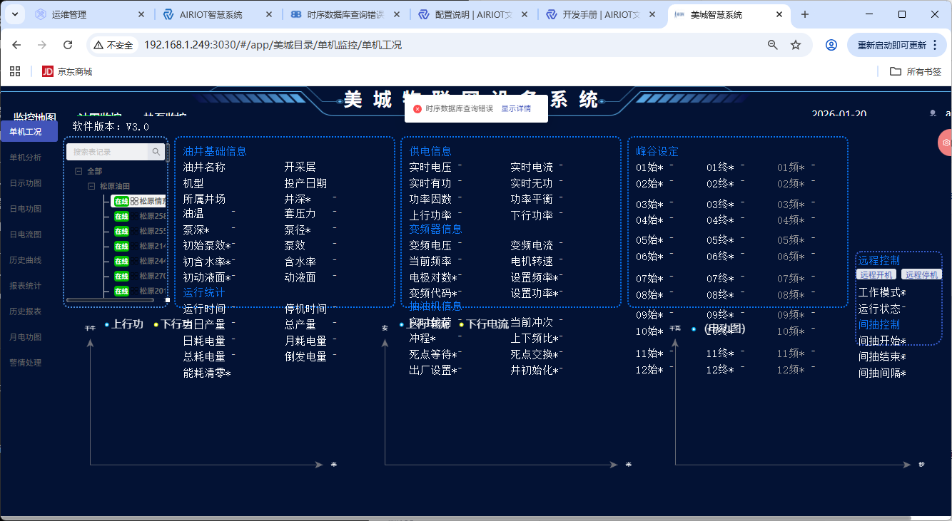

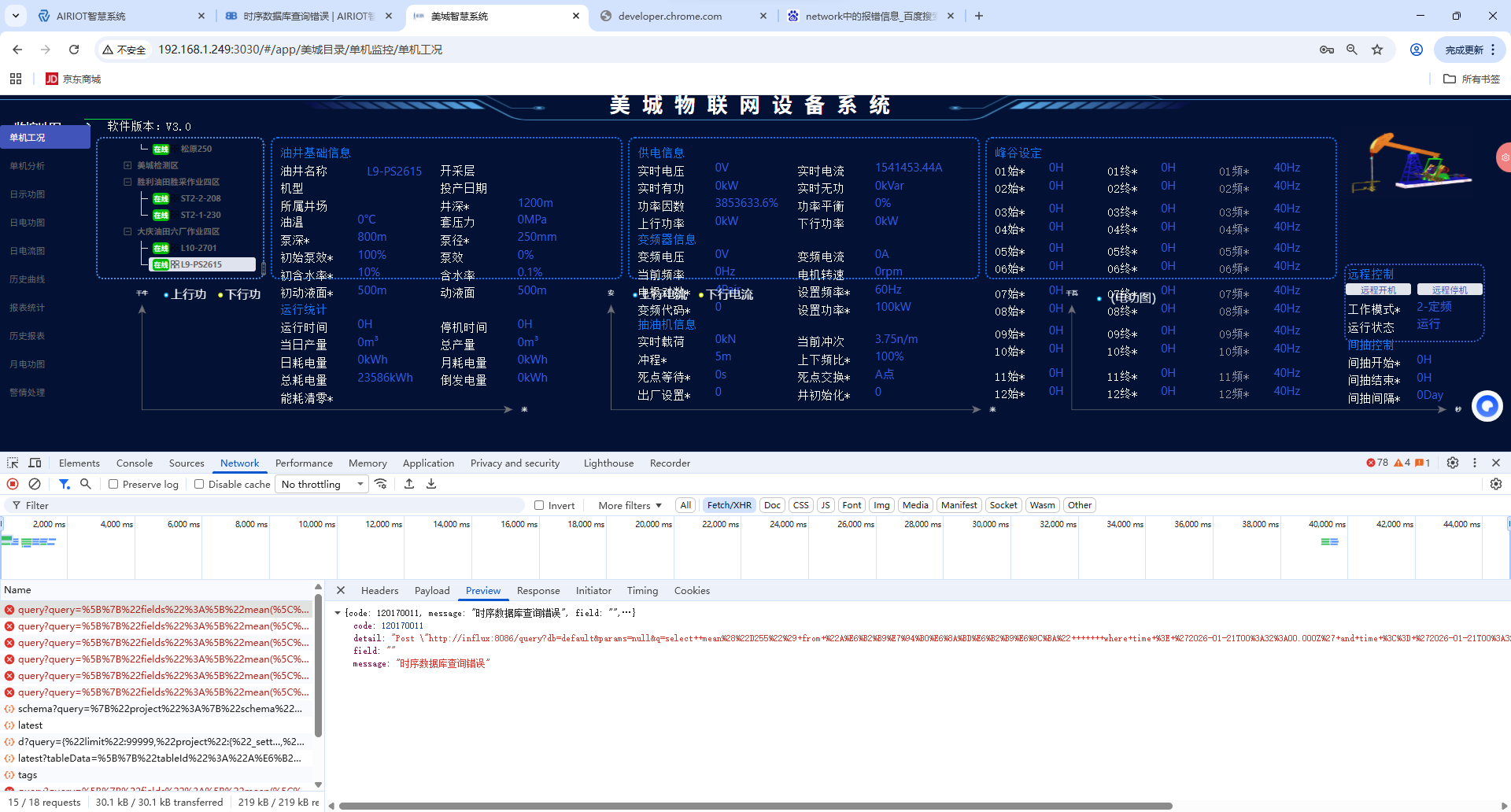

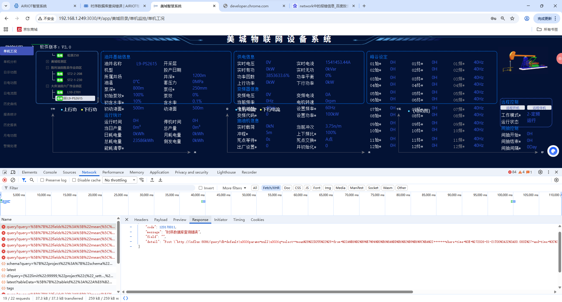

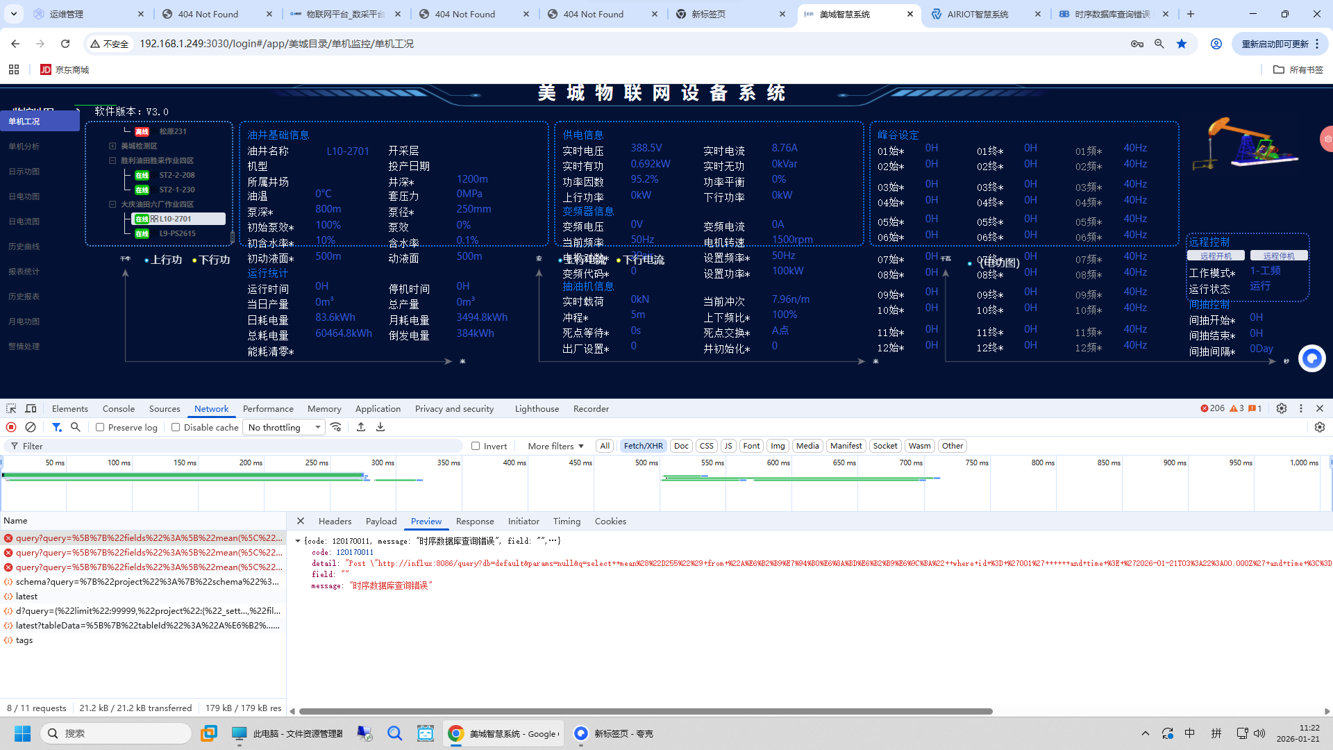

    时序数据库查询错误
    Post "http://influx:8086/query?db=default&params=null&q=select++mean("D675")+from+"A油田抽油机"++where+id+%3D+'242'++++++and+time+>+'2026-01-22T00%3A51%3A00.000Z'+and+time+<%3D+'2026-01-22T00%3A51%3A38.676Z'+++order+by+time+asc++%3B": dial tcp 172.19.0.47:8086: connect: connection refused
    不行,还是那样

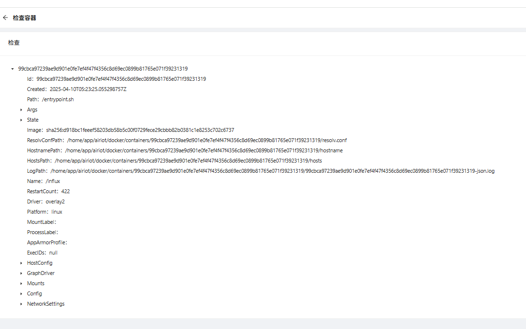

  • 时序数据库查询错误
    1 18903330657

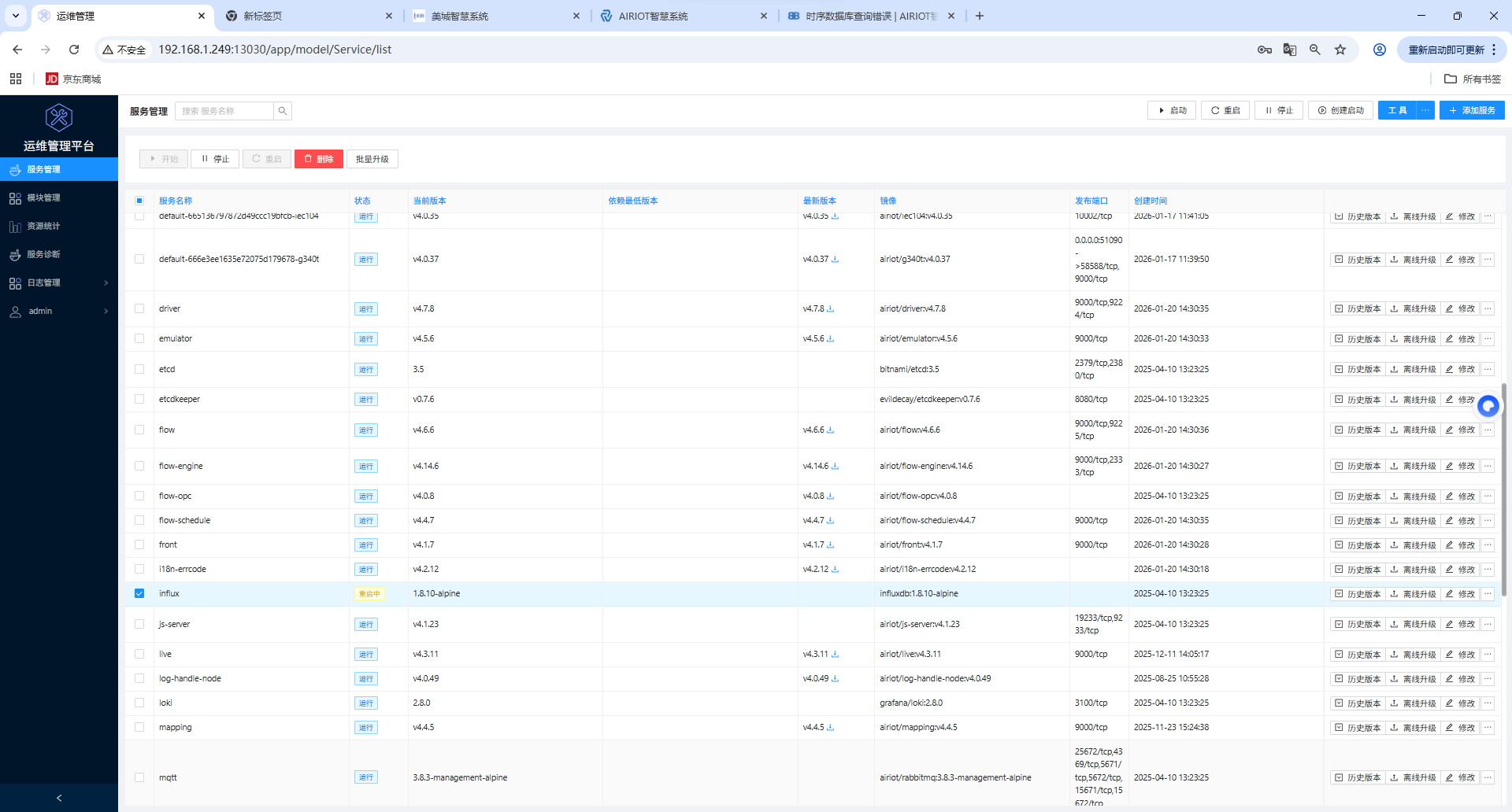

    检查容器
    检查
    树状形式文档形式
    "Id":"99cbca97239ae9d901e0fe7ef4f47f4356c8d69ec0899b81765e071f39231319",
    "Created":"2025-04-10T05:23:25.055298757Z",
    "Path":"/entrypoint.sh",
    "Args":["influxd"],
    "State":{
    "Status":"restarting",
    "Running":true,
    "Paused":false,
    "Restarting":true,
    "OOMKilled":false,
    "Dead":false,
    "Pid":0,
    "ExitCode":2,
    "Error":"",
    "StartedAt":"2026-01-21T06:07:44.066619948Z",
    "FinishedAt":"2026-01-21T06:07:52.837423483Z"
    "Image":"sha256:d918bc1feeef58203db58b5c00f0729fece29cbbb82b0381c1e8253c702c6737",
    "ResolvConfPath":"/home/app/airiot/docker/containers/99cbca97239ae9d901e0fe7ef4f47f4356c8d69ec0899b81765e071f39231319/resolv.conf",
    "HostnamePath":"/home/app/airiot/docker/containers/99cbca97239ae9d901e0fe7ef4f47f4356c8d69ec0899b81765e071f39231319/hostname",
    "HostsPath":"/home/app/airiot/docker/containers/99cbca97239ae9d901e0fe7ef4f47f4356c8d69ec0899b81765e071f39231319/hosts",
    "LogPath":"/home/app/airiot/docker/containers/99cbca97239ae9d901e0fe7ef4f47f4356c8d69ec0899b81765e071f39231319/99cbca97239ae9d901e0fe7ef4f47f4356c8d69ec0899b81765e071f39231319-json.log",
    "Name":"/influx",
    "RestartCount":422,
    "Driver":"overlay2",
    "Platform":"linux",
    "MountLabel":"",
    "ProcessLabel":"",
    "AppArmorProfile":"",
    "ExecIDs":null,
    "HostConfig":{
    "Binds":["/etc/localtime:/etc/localtime:ro",
    "/home/app/airiot/influxdb.conf:/etc/influxdb/influxdb.conf:rw",
    "/home/app/airiot/db/influxdb:/var/lib/influxdb:rw"],
    "ContainerIDFile":"",
    "LogConfig":{
    "Type":"json-file",
    "Config":{
    "max-file":"1",
    "max-size":"100m"}
    "NetworkMode":"app_backend",
    "PortBindings":{
    "RestartPolicy":{
    "Name":"always",
    "MaximumRetryCount":0
    "AutoRemove":false,
    "VolumeDriver":"",
    "VolumesFrom":null,
    "ConsoleSize":[0,
    0],
    "CapAdd":null,
    "CapDrop":null,
    "CgroupnsMode":"",
    "Dns":[],
    "DnsOptions":[],
    "DnsSearch":[],
    "ExtraHosts":null,
    "GroupAdd":null,
    "IpcMode":"private",
    "Cgroup":"",
    "Links":null,
    "OomScoreAdj":0,
    "PidMode":"",
    "Privileged":false,
    "PublishAllPorts":false,
    "ReadonlyRootfs":false,
    "SecurityOpt":null,
    "UTSMode":"",
    "UsernsMode":"",
    "ShmSize":67108864,
    "Runtime":"runc",
    "Isolation":"",
    "CpuShares":0,
    "Memory":0,
    "NanoCpus":0,
    "CgroupParent":"",
    "BlkioWeight":0,
    "BlkioWeightDevice":null,
    "BlkioDeviceReadBps":null,
    "BlkioDeviceWriteBps":null,
    "BlkioDeviceReadIOps":null,
    "BlkioDeviceWriteIOps":null,
    "CpuPeriod":0,
    "CpuQuota":0,
    "CpuRealtimePeriod":0,
    "CpuRealtimeRuntime":0,
    "CpusetCpus":"",
    "CpusetMems":"",
    "Devices":null,
    "DeviceCgroupRules":null,
    "DeviceRequests":null,
    "MemoryReservation":0,
    "MemorySwap":0,
    "MemorySwappiness":null,
    "OomKillDisable":false,
    "PidsLimit":null,
    "Ulimits":[{
    "Name":"nofile",
    "Hard":30720,
    "Soft":10240
    "Name":"nproc",
    "Hard":40960,
    "Soft":40960}],
    "CpuCount":0,
    "CpuPercent":0,
    "IOMaximumIOps":0,
    "IOMaximumBandwidth":0,
    "MaskedPaths":["/proc/asound",
    "/proc/acpi",
    "/proc/kcore",
    "/proc/keys",
    "/proc/latency_stats",
    "/proc/timer_list",
    "/proc/timer_stats",
    "/proc/sched_debug",
    "/proc/scsi",
    "/sys/firmware"],
    "ReadonlyPaths":["/proc/bus",
    "/proc/fs",
    "/proc/irq",
    "/proc/sys",
    "/proc/sysrq-trigger"]
    "GraphDriver":{
    "Data":{
    "LowerDir":"/home/app/airiot/docker/overlay2/159775c2d5ffbcc4febd19b20b8b1b96a3d56654beae1d3dd51eeb0b946ed96d-init/diff:/home/app/airiot/docker/overlay2/8f6721c6ed4c947f1de0c10f5bd9c822ace567b622f99c07e02c0c7c1a8855a3/diff:/home/app/airiot/docker/overlay2/ac27986bc9057820c03319680863f4a39df80a7efe0fbdb4c95e80860ea0a37a/diff:/home/app/airiot/docker/overlay2/53d2d0ada0bcfc3aed7218947a1b6d0bd54240257a29f8359d8055e0c040ae3f/diff:/home/app/airiot/docker/overlay2/08774460929f1109d6a650a655a31665a8550dc7e294a9e580012d23aeffa335/diff:/home/app/airiot/docker/overlay2/ac2a258a2658a00967bf11e588fce74ef9467fd152bde1b484f7d0224516eb58/diff:/home/app/airiot/docker/overlay2/5a33383a064853bf3e1d5e8a6ae496101fa56f84ae35a4a260e155b66756f7a8/diff:/home/app/airiot/docker/overlay2/20042e3a01fd5d0fdbe7101258b9d8be0096a664b4c7c3f611e5016bd1dc8609/diff",
    "MergedDir":"/home/app/airiot/docker/overlay2/159775c2d5ffbcc4febd19b20b8b1b96a3d56654beae1d3dd51eeb0b946ed96d/merged",
    "UpperDir":"/home/app/airiot/docker/overlay2/159775c2d5ffbcc4febd19b20b8b1b96a3d56654beae1d3dd51eeb0b946ed96d/diff",
    "WorkDir":"/home/app/airiot/docker/overlay2/159775c2d5ffbcc4febd19b20b8b1b96a3d56654beae1d3dd51eeb0b946ed96d/work"
    "Name":"overlay2"
    "Mounts":[{
    "Type":"bind",
    "Source":"/home/app/airiot/influxdb.conf",
    "Destination":"/etc/influxdb/influxdb.conf",
    "Mode":"rw",
    "RW":true,
    "Propagation":"rprivate"
    "Type":"bind",
    "Source":"/etc/localtime",
    "Destination":"/etc/localtime",
    "Mode":"ro",
    "RW":false,
    "Type":"bind",
    "Source":"/home/app/airiot/db/influxdb",
    "Destination":"/var/lib/influxdb",
    "Mode":"rw",
    "RW":true,
    "Propagation":"rprivate"}],
    "Config":{
    "Hostname":"99cbca97239a",
    "Domainname":"",
    "User":"",
    "AttachStdin":false,
    "AttachStdout":true,
    "AttachStderr":true,
    "ExposedPorts":{
    "8086/tcp":{
    "Tty":false,
    "OpenStdin":false,
    "StdinOnce":false,
    "Env":["INFLUXDB_DB=tsdb",
    "INFLUXDB_HTTP_AUTH_ENABLED=true",
    "INFLUXDB_ADMIN_USER=admin",
    "INFLUXDB_ADMIN_PASSWORD=qVPWSP9zxv",
    "PATH=/usr/local/sbin:/usr/local/bin:/usr/sbin:/usr/bin:/sbin:/bin",
    "INFLUXDB_VERSION=1.8.10"],
    "Cmd":["influxd"],
    "Image":"influxdb:1.8.10-alpine",
    "Volumes":{
    "/etc/influxdb/influxdb.conf":{
    "/etc/localtime":{
    "/var/lib/influxdb":{
    "WorkingDir":"",
    "Entrypoint":["/entrypoint.sh"],
    "OnBuild":null,
    "Labels":{
    "com.docker.compose.config-hash":"32b091278134a0c5c240f125023bf28f4356ea366f98c5c6e0bedc444a85d5d0",
    "com.docker.compose.container-number":"1",
    "com.docker.compose.depends_on":"",
    "com.docker.compose.image":"sha256:d918bc1feeef58203db58b5c00f0729fece29cbbb82b0381c1e8253c702c6737",
    "com.docker.compose.oneoff":"False",
    "com.docker.compose.project":"app",
    "com.docker.compose.project.config_files":"/home/app/docker-compose.yml",
    "com.docker.compose.project.working_dir":"/home/app",
    "com.docker.compose.service":"influx",
    "com.docker.compose.version":"2.2.2"}
    "NetworkSettings":{
    "Bridge":"",
    "SandboxID":"2789b77ac50a32b6c4b7817754c3cd4470bcc15e43faf699baf8b43215a10c74",
    "SandboxKey":"/var/run/docker/netns/2789b77ac50a",
    "Ports":{
    "HairpinMode":false,
    "LinkLocalIPv6Address":"",
    "LinkLocalIPv6PrefixLen":0,
    "SecondaryIPAddresses":null,
    "SecondaryIPv6Addresses":null,
    "EndpointID":"",
    "Gateway":"",
    "GlobalIPv6Address":"",
    "GlobalIPv6PrefixLen":0,
    "IPAddress":"",
    "IPPrefixLen":0,
    "IPv6Gateway":"",
    "MacAddress":"",
    "Networks":{
    "app_backend":{
    "IPAMConfig":null,
    "Links":null,
    "Aliases":["influx",
    "influx",
    "99cbca97239a"],
    "MacAddress":"",
    "DriverOpts":null,
    "NetworkID":"94c48086ea04993fe09fd01973b0dc02d13f8b8df0f27ec6cdae175eb847822c",
    "EndpointID":"",
    "Gateway":"",
    "IPAddress":"",
    "IPPrefixLen":0,
    "IPv6Gateway":"",
    "DNSNames":null
    "operation_backend":{
    "IPAMConfig":null,
    "Links":null,
    "influx",
    "99cbca97239a"],
    "MacAddress":"",
    "DriverOpts":null,
    "NetworkID":"476c45fbca168af20dc819dacaaefada42858ab16fad177450a9ad5b85f0d4e4",
    "EndpointID":"",
    "Gateway":"",
    "IPAddress":"",
    "IPPrefixLen":0,
    "IPv6Gateway":"",
    "DNSNames":null}}}}

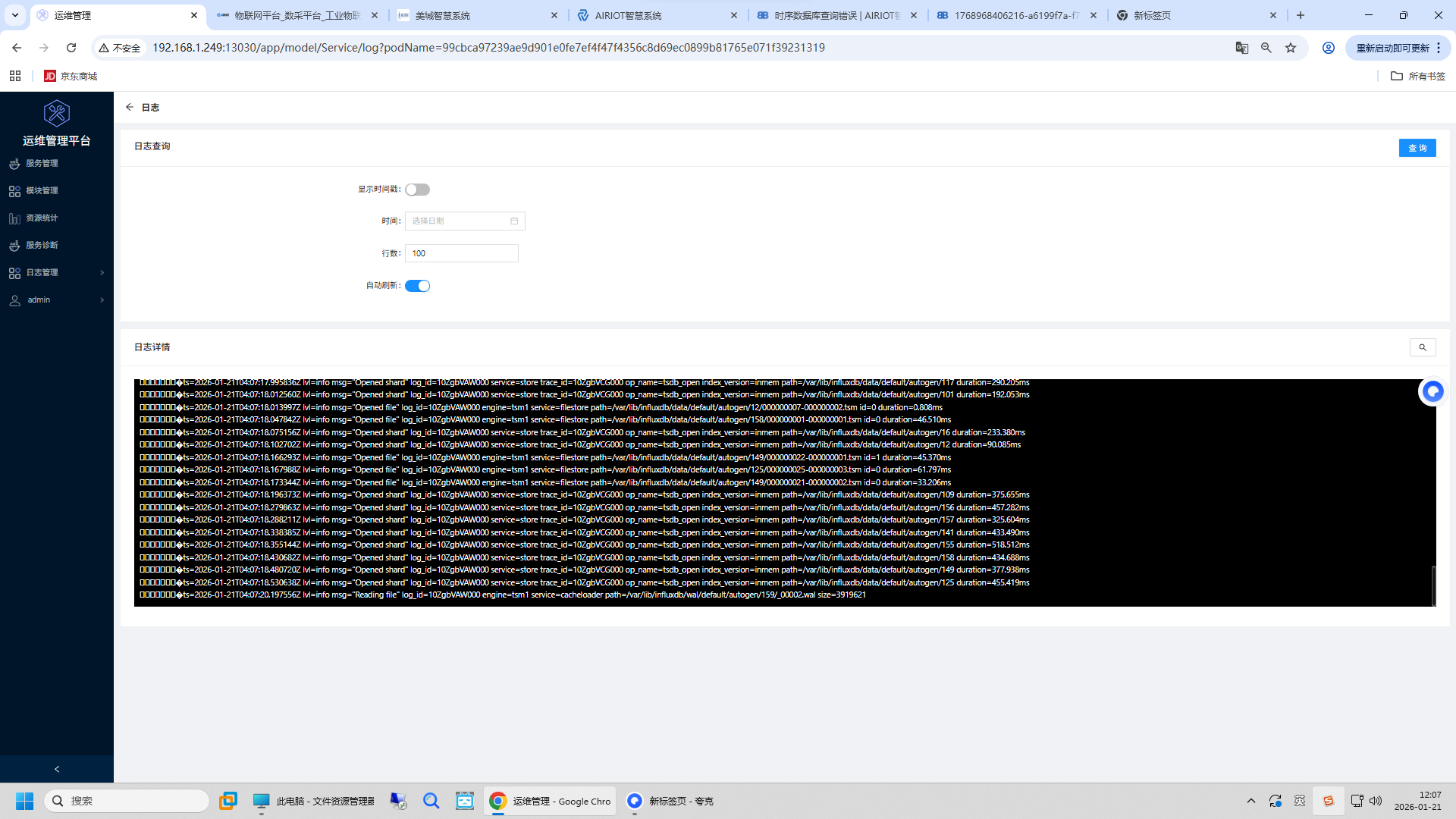

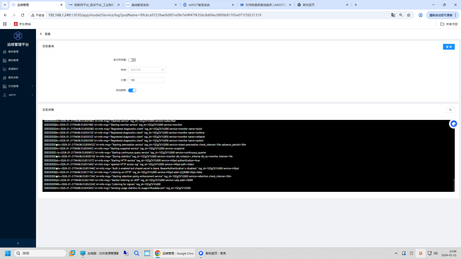

    日志查询
    显示时间戳
    时间
    行数
    100
    自动刷新
    日志详情
    fcrypto/tls.(*Conn).readFromUntil(0xc000131180, 0x2568340, 0xc0007ec068, 0x5, 0xc0007ec068, 0x1541840)
    0 /usr/local/go/src/crypto/tls/conn.go:802 +0xec
    Icrypto/tls.(*Conn).readRecordOrCCS(0xc000131180, 0x0, 0x0, 0xc0027d8dd0)
    1 /usr/local/go/src/crypto/tls/conn.go:609 +0x124
    #crypto/tls.(Conn).readRecord(...)
    /usr/local/go/src/crypto/tls/conn.go:577
    Scrypto/tls.(*Conn).Read(0xc000131180, 0xc016374000, 0x1000, 0x1000, 0x0, 0x0, 0x0)
    2 /usr/local/go/src/crypto/tls/conn.go:1255 +0x161
    onet/http.(*persistConn).Read(0xc00022ed80, 0xc016374000, 0x1000, 0x1000, 0xc0027d8ed8, 0x45c720, 0xc0027d8ed8)
    4 /usr/local/go/src/net/http/transport.go:1758 +0x75
    #bufio.(*Reader).fill(0xc01631b380)
    - /usr/local/go/src/bufio/bufio.go:100 +0x103
    Jbufio.(*Reader).Peek(0xc01631b380, 0x1, 0x2, 0x0, 0x0, 0xc01618f200, 0x0)
    , /usr/local/go/src/bufio/bufio.go:138 +0x4f
    /net/http.(persistConn).readLoop(0xc00022ed80)
    5 /usr/local/go/src/net/http/transport.go:1911 +0x1d6
    created by net/http.(*Transport).dialConn
    5 /usr/local/go/src/net/http/transport.go:1580 +0xb0d
    goroutine 1556 [select]:
    ]net/http.setRequestCancel.func3(0x0, 0xc002367440, 0xc000eab4a0, 0xc00b72c878, 0xc00009b9e0)
    0 /usr/local/go/src/net/http/client.go:321 +0xcf
    %created by net/http.setRequestCancel
    1 /usr/local/go/src/net/http/client.go:320 +0x24b
    �ts=2026-01-21T04:08:04.006818Z lvl=info msg="InfluxDB starting" log_id=10ZgeOeW000 version=1.8.10 branch=1.8 commit=688e697c51fd
    its=2026-01-21T04:08:04.006850Z lvl=info msg="Go runtime" log_id=10ZgeOeW000 version=go1.13.8 maxprocs=12
    zts=2026-01-21T04:08:04.020099Z lvl=info msg="Using data dir" log_id=10ZgeOeW000 service=store path=/var/lib/influxdb/data
    �ts=2026-01-21T04:08:04.020154Z lvl=info msg="Compaction settings" log_id=10ZgeOeW000 service=store max_concurrent_compactions=6 throughput_bytes_per_second=50331648 throughput_bytes_per_second_burst=50331648
    �ts=2026-01-21T04:08:04.020166Z lvl=info msg="Open store (start)" log_id=10ZgeOeW000 service=store trace_id=10ZgeOi0000 op_name=tsdb_open op_event=start
    �ts=2026-01-21T04:08:04.034575Z lvl=info msg="Opened file" log_id=10ZgeOeW000 engine=tsm1 service=filestore path=/var/lib/influxdb/data/_internal/monitor/153/000000001-000000001.tsm id=0 duration=0.956ms
    �ts=2026-01-21T04:08:04.039199Z lvl=info msg="Opened shard" log_id=10ZgeOeW000 service=store trace_id=10ZgeOi0000 op_name=tsdb_open index_version=inmem path=/var/lib/influxdb/data/_internal/monitor/171 duration=13.495ms
    �ts=2026-01-21T04:08:04.055619Z lvl=info msg="Opened file" log_id=10ZgeOeW000 engine=tsm1 service=filestore path=/var/lib/influxdb/data/_internal/monitor/152/000000013-000000002.tsm id=0 duration=14.055ms
    �ts=2026-01-21T04:08:04.067781Z lvl=info msg="Opened file" log_id=10ZgeOeW000 engine=tsm1 service=filestore path=/var/lib/influxdb/data/_internal/monitor/150/000000017-000000002.tsm id=0 duration=11.237ms
    �ts=2026-01-21T04:08:04.068607Z lvl=info msg="Reading file" log_id=10ZgeOeW000 engine=tsm1 service=cacheloader path=/var/lib/influxdb/wal/default/autogen/159/_00001.wal size=10492523
    �ts=2026-01-21T04:08:04.047141Z lvl=info msg="Opened file" log_id=10ZgeOeW000 engine=tsm1 service=filestore path=/var/lib/influxdb/data/default/autogen/167/000000001-000000001.tsm id=0 duration=4.866ms
    �ts=2026-01-21T04:08:04.082647Z lvl=info msg="Opened file" log_id=10ZgeOeW000 engine=tsm1 service=filestore path=/var/lib/influxdb/data/_internal/monitor/151/000000016-000000003.tsm id=0 duration=43.221ms
    �ts=2026-01-21T04:08:04.085514Z lvl=info msg="Opened file" log_id=10ZgeOeW000 engine=tsm1 service=filestore path=/var/lib/influxdb/data/_internal/monitor/154/000000003-000000002.tsm id=0 duration=48.510ms
    �ts=2026-01-21T04:08:04.088544Z lvl=info msg="Opened file" log_id=10ZgeOeW000 engine=tsm1 service=filestore path=/var/lib/influxdb/data/default/autogen/22/000000029-000000002.tsm id=0 duration=40.555ms
    �ts=2026-01-21T04:08:04.124605Z lvl=info msg="Opened file" log_id=10ZgeOeW000 engine=tsm1 service=filestore path=/var/lib/influxdb/data/default/autogen/2/000000091-000000002.tsm id=0 duration=45.815ms
    �ts=2026-01-21T04:08:04.128684Z lvl=info msg="Opened file" log_id=10ZgeOeW000 engine=tsm1 service=filestore path=/var/lib/influxdb/data/default/autogen/101/000000051-000000002.tsm id=0 duration=79.678ms
    �ts=2026-01-21T04:08:04.134553Z lvl=info msg="Opened shard" log_id=10ZgeOeW000 service=store trace_id=10ZgeOi0000 op_name=tsdb_open index_version=inmem path=/var/lib/influxdb/data/default/autogen/167 duration=92.909ms
    �ts=2026-01-21T04:08:04.137430Z lvl=info msg="Opened file" log_id=10ZgeOeW000 engine=tsm1 service=filestore path=/var/lib/influxdb/data/default/autogen/14/000000042-000000002.tsm id=0 duration=1.616ms
    �ts=2026-01-21T04:08:04.159416Z lvl=info msg="Opened file" log_id=10ZgeOeW000 engine=tsm1 service=filestore path=/var/lib/influxdb/data/_internal/monitor/148/000000017-000000002.tsm id=0 duration=122.647ms
    �ts=2026-01-21T04:08:04.167518Z lvl=info msg="Opened file" log_id=10ZgeOeW000 engine=tsm1 service=filestore path=/var/lib/influxdb/data/_internal/monitor/161/000000001-000000001.tsm id=0 duration=130.554ms
    �ts=2026-01-21T04:08:04.301923Z lvl=info msg="Opened shard" log_id=10ZgeOeW000 service=store trace_id=10ZgeOi0000 op_name=tsdb_open index_version=inmem path=/var/lib/influxdb/data/_internal/monitor/154 duration=278.270ms
    �ts=2026-01-21T04:08:04.307995Z lvl=info msg="Opened file" log_id=10ZgeOeW000 engine=tsm1 service=filestore path=/var/lib/influxdb/data/default/autogen/109/000000015-000000002.tsm id=0 duration=5.403ms
    �ts=2026-01-21T04:08:04.352162Z lvl=info msg="Opened shard" log_id=10ZgeOeW000 service=store trace_id=10ZgeOi0000 op_name=tsdb_open index_version=inmem path=/var/lib/influxdb/data/default/autogen/22 duration=310.458ms
    �ts=2026-01-21T04:08:04.352236Z lvl=info msg="Opened shard" log_id=10ZgeOeW000 service=store trace_id=10ZgeOi0000 op_name=tsdb_open index_version=inmem path=/var/lib/influxdb/data/_internal/monitor/150 duration=319.195ms
    �ts=2026-01-21T04:08:04.352508Z lvl=info msg="Opened shard" log_id=10ZgeOeW000 service=store trace_id=10ZgeOi0000 op_name=tsdb_open index_version=inmem path=/var/lib/influxdb/data/default/autogen/14 duration=217.894ms
    �ts=2026-01-21T04:08:04.353601Z lvl=info msg="Opened shard" log_id=10ZgeOeW000 service=store trace_id=10ZgeOi0000 op_name=tsdb_open index_version=inmem path=/var/lib/influxdb/data/default/autogen/2 duration=301.614ms
    �ts=2026-01-21T04:08:04.356161Z lvl=info msg="Opened file" log_id=10ZgeOeW000 engine=tsm1 service=filestore path=/var/lib/influxdb/data/default/autogen/12/000000007-000000002.tsm id=0 duration=0.563ms
    �ts=2026-01-21T04:08:04.359652Z lvl=info msg="Opened file" log_id=10ZgeOeW000 engine=tsm1 service=filestore path=/var/lib/influxdb/data/default/autogen/13/000000054-000000002.tsm id=0 duration=5.505ms
    �ts=2026-01-21T04:08:04.361045Z lvl=info msg="Opened file" log_id=10ZgeOeW000 engine=tsm1 service=filestore path=/var/lib/influxdb/data/default/autogen/125/000000025-000000003.tsm id=0 duration=7.932ms
    �ts=2026-01-21T04:08:04.362146Z lvl=info msg="Opened file" log_id=10ZgeOeW000 engine=tsm1 service=filestore path=/var/lib/influxdb/data/default/autogen/117/000000020-000000002.tsm id=0 duration=9.304ms
    �ts=2026-01-21T04:08:04.369001Z lvl=info msg="Opened shard" log_id=10ZgeOeW000 service=store trace_id=10ZgeOi0000 op_name=tsdb_open index_version=inmem path=/var/lib/influxdb/data/default/autogen/101 duration=329.757ms
    �ts=2026-01-21T04:08:04.369079Z lvl=info msg="Opened shard" log_id=10ZgeOeW000 service=store trace_id=10ZgeOi0000 op_name=tsdb_open index_version=inmem path=/var/lib/influxdb/data/_internal/monitor/153 duration=344.526ms
    �ts=2026-01-21T04:08:04.369082Z lvl=info msg="Opened shard" log_id=10ZgeOeW000 service=store trace_id=10ZgeOi0000 op_name=tsdb_open index_version=inmem path=/var/lib/influxdb/data/_internal/monitor/148 duration=344.335ms
    �ts=2026-01-21T04:08:04.394525Z lvl=info msg="Opened shard" log_id=10ZgeOeW000 service=store trace_id=10ZgeOi0000 op_name=tsdb_open index_version=inmem path=/var/lib/influxdb/data/_internal/monitor/152 duration=370.829ms
    �ts=2026-01-21T04:08:04.406523Z lvl=info msg="Opened shard" log_id=10ZgeOeW000 service=store trace_id=10ZgeOi0000 op_name=tsdb_open index_version=inmem path=/var/lib/influxdb/data/_internal/monitor/161 duration=381.877ms
    �ts=2026-01-21T04:08:04.406703Z lvl=info msg="Opened shard" log_id=10ZgeOeW000 service=store trace_id=10ZgeOi0000 op_name=tsdb_open index_version=inmem path=/var/lib/influxdb/data/_internal/monitor/151 duration=364.633ms
    �ts=2026-01-21T04:08:04.419399Z lvl=info msg="Opened file" log_id=10ZgeOeW000 engine=tsm1 service=filestore path=/var/lib/influxdb/data/default/autogen/157/000000001-000000001.tsm id=0 duration=26.424ms
    �ts=2026-01-21T04:08:04.441352Z lvl=info msg="Opened file" log_id=10ZgeOeW000 engine=tsm1 service=filestore path=/var/lib/influxdb/data/default/autogen/149/000000021-000000002.tsm id=0 duration=24.842ms
    �ts=2026-01-21T04:08:04.444536Z lvl=info msg="Opened shard" log_id=10ZgeOeW000 service=store trace_id=10ZgeOi0000 op_name=tsdb_open index_version=inmem path=/var/lib/influxdb/data/default/autogen/12 duration=92.277ms
    �ts=2026-01-21T04:08:04.446552Z lvl=info msg="Opened file" log_id=10ZgeOeW000 engine=tsm1 service=filestore path=/var/lib/influxdb/data/default/autogen/149/000000022-000000001.tsm id=1 duration=31.498ms
    �ts=2026-01-21T04:08:04.450811Z lvl=info msg="Opened file" log_id=10ZgeOeW000 engine=tsm1 service=filestore path=/var/lib/influxdb/data/default/autogen/133/000000024-000000003.tsm id=0 duration=67.302ms
    �ts=2026-01-21T04:08:04.460217Z lvl=info msg="Opened file" log_id=10ZgeOeW000 engine=tsm1 service=filestore path=/var/lib/influxdb/data/default/autogen/156/000000001-000000001.tsm id=0 duration=68.538ms
    �ts=2026-01-21T04:08:04.460803Z lvl=info msg="Opened file" log_id=10ZgeOeW000 engine=tsm1 service=filestore path=/var/lib/influxdb/data/default/autogen/141/000000025-000000002.tsm id=0 duration=12.187ms
    �ts=2026-01-21T04:08:04.482003Z lvl=info msg="Opened file" log_id=10ZgeOeW000 engine=tsm1 service=filestore path=/var/lib/influxdb/data/default/autogen/158/000000001-000000001.tsm id=0 duration=59.120ms
    �ts=2026-01-21T04:08:04.512310Z lvl=info msg="Opened shard" log_id=10ZgeOeW000 service=store trace_id=10ZgeOi0000 op_name=tsdb_open index_version=inmem path=/var/lib/influxdb/data/default/autogen/13 duration=158.675ms
    �ts=2026-01-21T04:08:04.528871Z lvl=info msg="Reading file" log_id=10ZgeOeW000 engine=tsm1 service=cacheloader path=/var/lib/influxdb/wal/default/autogen/163/_00001.wal size=10522280
    �ts=2026-01-21T04:08:04.657427Z lvl=info msg="Opened file" log_id=10ZgeOeW000 engine=tsm1 service=filestore path=/var/lib/influxdb/data/default/autogen/16/000000031-000000002.tsm id=0 duration=1.265ms
    �ts=2026-01-21T04:08:04.838100Z lvl=info msg="Opened shard" log_id=10ZgeOeW000 service=store trace_id=10ZgeOi0000 op_name=tsdb_open index_version=inmem path=/var/lib/influxdb/data/default/autogen/16 duration=325.737ms
    �ts=2026-01-21T04:08:04.886390Z lvl=info msg="Opened shard" log_id=10ZgeOeW000 service=store trace_id=10ZgeOi0000 op_name=tsdb_open index_version=inmem path=/var/lib/influxdb/data/default/autogen/109 duration=584.407ms
    �ts=2026-01-21T04:08:04.962608Z lvl=info msg="Opened shard" log_id=10ZgeOeW000 service=store trace_id=10ZgeOi0000 op_name=tsdb_open index_version=inmem path=/var/lib/influxdb/data/default/autogen/117 duration=610.387ms
    �ts=2026-01-21T04:08:04.965622Z lvl=info msg="Opened file" log_id=10ZgeOeW000 engine=tsm1 service=filestore path=/var/lib/influxdb/data/default/autogen/160/000000001-000000001.tsm id=0 duration=6.232ms
    �ts=2026-01-21T04:08:04.965743Z lvl=info msg="Reading file" log_id=10ZgeOeW000 engine=tsm1 service=cacheloader path=/var/lib/influxdb/wal/default/autogen/160/_00001.wal size=9214353
    �ts=2026-01-21T04:08:04.966667Z lvl=info msg="Reading file" log_id=10ZgeOeW000 engine=tsm1 service=cacheloader path=/var/lib/influxdb/wal/default/autogen/162/_00001.wal size=10584142
    �ts=2026-01-21T04:08:04.984834Z lvl=info msg="Opened file" log_id=10ZgeOeW000 engine=tsm1 service=filestore path=/var/lib/influxdb/data/default/autogen/170/000000001-000000001.tsm id=0 duration=0.085ms
    �ts=2026-01-21T04:08:05.097531Z lvl=info msg="Opened shard" log_id=10ZgeOeW000 service=store trace_id=10ZgeOi0000 op_name=tsdb_open index_version=inmem path=/var/lib/influxdb/data/default/autogen/156 duration=728.422ms
    �ts=2026-01-21T04:08:05.097980Z lvl=info msg="Opened file" log_id=10ZgeOeW000 engine=tsm1 service=filestore path=/var/lib/influxdb/data/default/autogen/168/000000001-000000001.tsm id=0 duration=0.069ms
    �ts=2026-01-21T04:08:05.128509Z lvl=info msg="Opened shard" log_id=10ZgeOeW000 service=store trace_id=10ZgeOi0000 op_name=tsdb_open index_version=inmem path=/var/lib/influxdb/data/default/autogen/141 duration=721.764ms
    �ts=2026-01-21T04:08:05.129366Z lvl=info msg="Opened file" log_id=10ZgeOeW000 engine=tsm1 service=filestore path=/var/lib/influxdb/data/default/autogen/169/000000001-000000001.tsm id=0 duration=0.064ms
    �ts=2026-01-21T04:08:05.138146Z lvl=info msg="Opened shard" log_id=10ZgeOeW000 service=store trace_id=10ZgeOi0000 op_name=tsdb_open index_version=inmem path=/var/lib/influxdb/data/default/autogen/170 duration=175.481ms
    �ts=2026-01-21T04:08:05.146557Z lvl=info msg="Opened file" log_id=10ZgeOeW000 engine=tsm1 service=filestore path=/var/lib/influxdb/data/default/autogen/17/000000029-000000002.tsm id=0 duration=7.280ms
    �ts=2026-01-21T04:08:05.162070Z lvl=info msg="Opened shard" log_id=10ZgeOeW000 service=store trace_id=10ZgeOi0000 op_name=tsdb_open index_version=inmem path=/var/lib/influxdb/data/default/autogen/149 duration=755.478ms
    �ts=2026-01-21T04:08:05.164395Z lvl=info msg="Opened file" log_id=10ZgeOeW000 engine=tsm1 service=filestore path=/var/lib/influxdb/data/default/autogen/20/000000030-000000002.tsm id=0 duration=1.423ms
    �ts=2026-01-21T04:08:05.203901Z lvl=info msg="Opened shard" log_id=10ZgeOeW000 service=store trace_id=10ZgeOi0000 op_name=tsdb_open index_version=inmem path=/var/lib/influxdb/data/default/autogen/125 duration=851.364ms
    �ts=2026-01-21T04:08:05.205816Z lvl=info msg="Opened file" log_id=10ZgeOeW000 engine=tsm1 service=filestore path=/var/lib/influxdb/data/default/autogen/21/000000027-000000002.tsm id=0 duration=0.952ms
    �ts=2026-01-21T04:08:05.207518Z lvl=info msg="Opened shard" log_id=10ZgeOeW000 service=store trace_id=10ZgeOi0000 op_name=tsdb_open index_version=inmem path=/var/lib/influxdb/data/default/autogen/133 duration=838.464ms
    �ts=2026-01-21T04:08:05.209242Z lvl=info msg="Opened file" log_id=10ZgeOeW000 engine=tsm1 service=filestore path=/var/lib/influxdb/data/default/autogen/34/000000030-000000002.tsm id=0 duration=0.879ms
    �ts=2026-01-21T04:08:05.212304Z lvl=info msg="Opened shard" log_id=10ZgeOeW000 service=store trace_id=10ZgeOi0000 op_name=tsdb_open index_version=inmem path=/var/lib/influxdb/data/default/autogen/169 duration=83.332ms
    �ts=2026-01-21T04:08:05.223385Z lvl=info msg="Opened file" log_id=10ZgeOeW000 engine=tsm1 service=filestore path=/var/lib/influxdb/data/default/autogen/27/000000031-000000002.tsm id=0 duration=10.223ms
    �ts=2026-01-21T04:08:05.247544Z lvl=info msg="Opened shard" log_id=10ZgeOeW000 service=store trace_id=10ZgeOi0000 op_name=tsdb_open index_version=inmem path=/var/lib/influxdb/data/default/autogen/168 duration=149.947ms
    �ts=2026-01-21T04:08:05.257623Z lvl=info msg="Opened file" log_id=10ZgeOeW000 engine=tsm1 service=filestore path=/var/lib/influxdb/data/default/autogen/28/000000030-000000002.tsm id=0 duration=9.169ms
    �ts=2026-01-21T04:08:05.322194Z lvl=info msg="Opened shard" log_id=10ZgeOeW000 service=store trace_id=10ZgeOi0000 op_name=tsdb_open index_version=inmem path=/var/lib/influxdb/data/default/autogen/157 duration=953.081ms
    �ts=2026-01-21T04:08:05.325190Z lvl=info msg="Opened file" log_id=10ZgeOeW000 engine=tsm1 service=filestore path=/var/lib/influxdb/data/default/autogen/29/000000030-000000002.tsm id=0 duration=1.132ms
    �ts=2026-01-21T04:08:05.376154Z lvl=info msg="Opened shard" log_id=10ZgeOeW000 service=store trace_id=10ZgeOi0000 op_name=tsdb_open index_version=inmem path=/var/lib/influxdb/data/default/autogen/158 duration=981.577ms
    �ts=2026-01-21T04:08:05.377059Z lvl=info msg="Reading file" log_id=10ZgeOeW000 engine=tsm1 service=cacheloader path=/var/lib/influxdb/wal/default/autogen/172/_00001.wal size=1449992

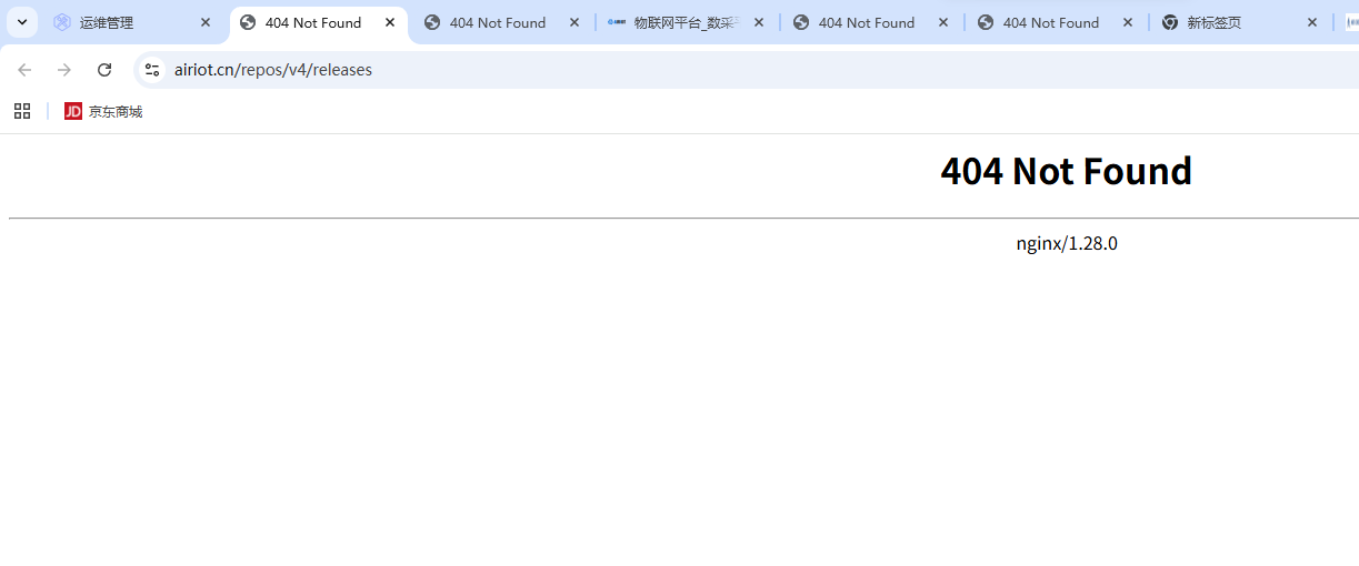

    网上没有这个程序,请给我发到邮箱里484432@qq.com,我自己在本地离线升级一下试试
  • 时序数据库查询错误
    1 18903330657
    过一会,influx又在重启中
  • 时序数据库查询错误
    1 18903330657
    influx的历史版本地址,https://airiot.cn/repos/v4/releases,没内容
  • 时序数据库查询错误
    1 18903330657
    手动重启之后也不行

    有的功能画面显示如下:
    Post "http://influx:8086/query?db=default&params=null&q=select++mean("D675")+from+"A油田抽油机"++where+id+%3D+'255'++++++and+time+>+'2026-01-20T07%3A10%3A00.000Z'+and+time+<%3D+'2026-01-20T07%3A10%3A36.460Z'+++order+by+time+asc++%3B": dial tcp 172.19.0.40:8086: connect: connection refused
    请问老师如何处理?
