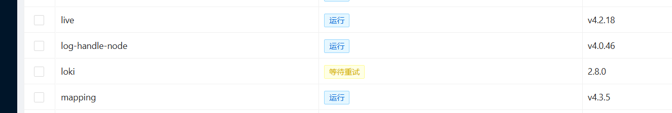

运维平台中loki服务启动处于等待状态

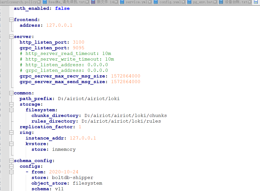

@核桃酥 已经修改了,
但还是重新启动不了,报如下错误
failed parsing config: ./local-config.yaml: yaml: unmarshal errors:
line 44: field allow_structured_metadata not found in type validation.plain. Use-config.expand-env=true
flag if you want to expand environment variables in your config file
