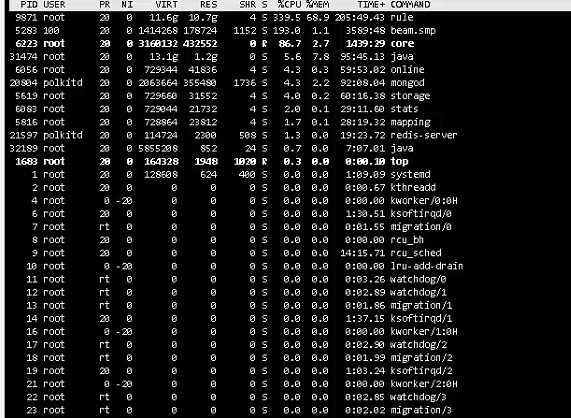

    liyitao12
    #34
    9871 root 20 0 11.6g 10.7g 4 S 339.5 68.9 205:49.43 rule
    5283 100 20 0 1414268 178724 1152 S 193.0 1.1 3589:48 beam.smp
    6223 root 20 0 3160132 432552 0 R 86.7 2.7 1439:29 core
    31474 root 20 0 13.1g 1.2g 0 S 5.6 7.8 95:45.13 java
    6056 root 20 0 729344 41836 4 S 4.3 0.3 59:53.02 online
    20804 polkitd 20 0 2063664 355480 1736 S 4.3 2.2 92:08.04 mongod
    5619 root 20 0 729660 31552 4 S 4.0 0.2 60:16.38 storage
    6083 root 20 0 729044 21732 4 S 2.0 0.1 29:11.60 stats
    5816 root 20 0 728864 23812 4 S 1.7 0.1 28:19.32 mapping
    21597 polkitd 20 0 114724 2300 508 S 1.3 0.0 19:23.72 redis-server
    32189 root 20 0 5855208 852 24 S 0.7 0.0 7:07.01 java
    1683 root 20 0 164328 1948 1020 R 0.3 0.0 0:00.10 top
    1 root 20 0 128608 624 400 S 0.0 0.0 1:09.09 systemd
    2 root 20 0 0 0 0 S 0.0 0.0 0:00.67 kthreadd

    hp
    #36
    rule 有问题进程杀死吧,kill -9 9871
    然后再docker-compose down再docker-compose up -d

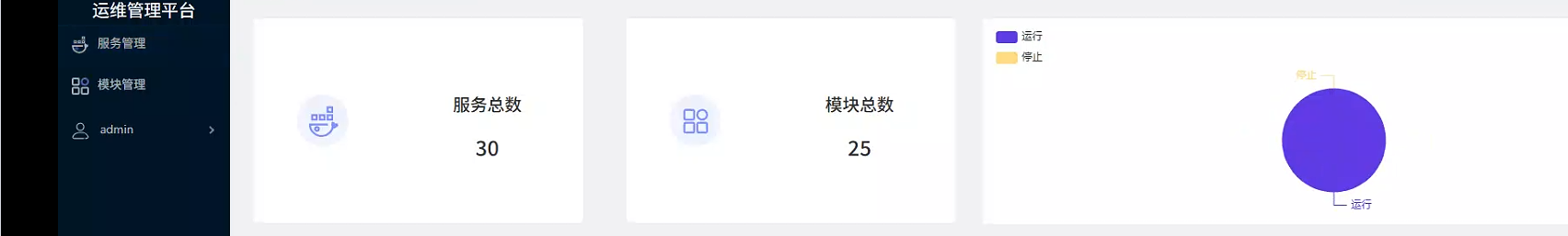

    liyitao12
    #38
    image.png重启完
  • hpH 离线
    hpH 离线
    hp
    #39
    还是报错吗,运维里服务都是运行状态了吗

    liyitao12
    #40
    内存占用率不高了但是还是有报警
    @hp
  • L 离线
    L 离线
    liyitao12
    #41
    服务显示都在运行

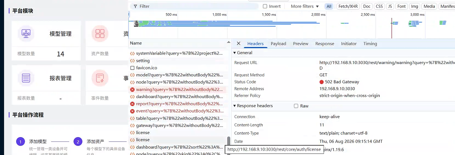

    liyitao12
    #44
  • L 离线
    L 离线
    liyitao12
    #45
    昨天按照你说的重启完平台直接无法采集数据了 @hp

    hp
    #47
    连不上mqtt了,docker logs emqx看下mqtt容器日志,再telnet看下mqtt连通性
