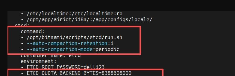

    6. 修改 YAML 配置
    etcd 容器配置需要修改 command:
    etcd:
    command:
    - /opt/bitnami/scripts/etcd/run.sh
    - --auto-compaction-retention=1
    - --auto-compaction-mode=periodic
    container_name: etcd
    environment:
    - ETCD_ROOT_PASSWORD=dell123
    - ETCD_QUOTA_BACKEND_BYTES=8388608000
    image: bitnami/etcd:3.5
    logging:
    driver: json-file
    options:
    max-file: "1"
    max-size: 100m
    networks:
    - backend
    - operation
    ports:
    - 2379:2379
    - 2380:2380
    restart: always
    ulimits:
    nofile:
    hard: 3072
    soft: 1024
    nproc: 4096
    volumes:
    - /opt/app/airiot/db/etcd:/bitnami/etcd
    - /etc/localtime:/etc/localtime
    增加框起来的内容
    e850977e-7bb9-4400-bdb4-85026f3f517d-image.png ![51990514-aabb-45eb-bcf0-34cbab18238c-img_v3_02vk_9ec2a6f2-6e10-4aa9-a745-789e7f9cd8ag.jpg]
