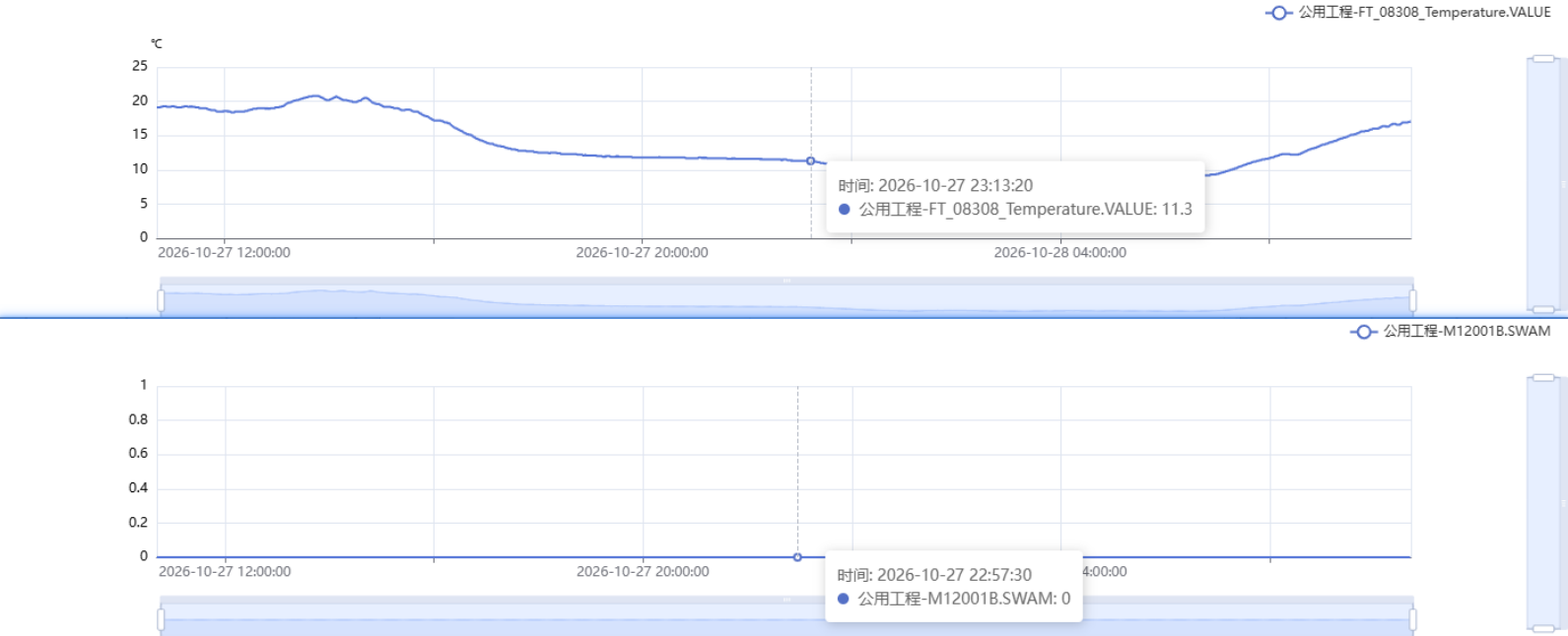

<?xml version="1.0" encoding="UTF-8"?><rss xmlns:dc="http://purl.org/dc/elements/1.1/" xmlns:content="http://purl.org/rss/1.0/modules/content/" xmlns:atom="http://www.w3.org/2005/Atom" version="2.0"><channel><title><![CDATA[最近2-3周，经常出现数据点突然连不上的情况]]></title><description><![CDATA[<p dir="auto"><img src="/assets/uploads/files/1793234835257-d2b3c89b-03be-48fb-a90e-72fd33fd4cb6-8a8b69453e383b792195aedf398f8811.png" alt="d2b3c89b-03be-48fb-a90e-72fd33fd4cb6-8a8b69453e383b792195aedf398f8811.png" class=" img-fluid img-markdown" />   突然某个时间断开，然后又好用了，然后网络是通的，有哪些情况会出现这些问题呀</p>

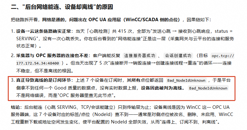

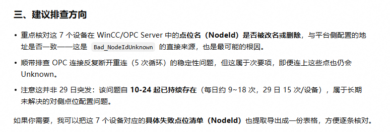

]]></description><link>https://qa.airiot.tech/topic/2900/最近2-3周-经常出现数据点突然连不上的情况</link><generator>RSS for Node</generator><lastBuildDate>Thu, 29 Oct 2026 06:06:50 GMT</lastBuildDate><atom:link href="https://qa.airiot.tech/topic/2900.rss" rel="self" type="application/rss+xml"/><pubDate>Thu, 29 Oct 2026 00:48:09 GMT</pubDate><ttl>60</ttl><item><title><![CDATA[Reply to 最近2-3周，经常出现数据点突然连不上的情况 on Thu, 29 Oct 2026 03:41:33 GMT]]></title><description><![CDATA[<p dir="auto">log日志和ai解析皆如上所示  <a class="plugin-mentions-user plugin-mentions-a" href="https://qa.airiot.tech/uid/4">@核桃酥</a> <a class="plugin-mentions-user plugin-mentions-a" href="https://qa.airiot.tech/uid/122">@Zhang书书</a></p>

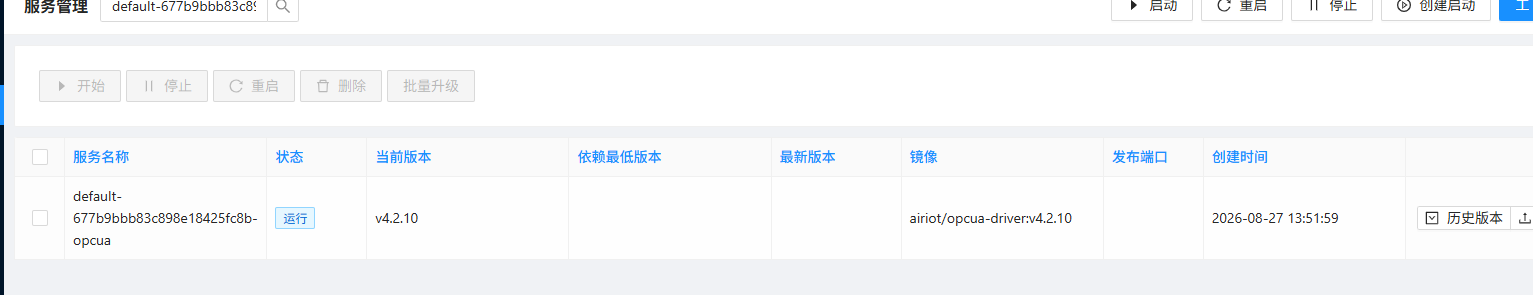

]]></description><link>https://qa.airiot.tech/post/21019</link><guid isPermaLink="true">https://qa.airiot.tech/post/21019</guid><dc:creator><![CDATA[ggzn_chp]]></dc:creator><pubDate>Thu, 29 Oct 2026 03:41:33 GMT</pubDate></item><item><title><![CDATA[Reply to 最近2-3周，经常出现数据点突然连不上的情况 on Thu, 29 Oct 2026 03:40:24 GMT]]></title><description><![CDATA[<p dir="auto"><a href="https://wormhole.app/XndMzP#X0pqcUfoNL4GjAJa_44v-w" rel="nofollow ugc">https://wormhole.app/XndMzP#X0pqcUfoNL4GjAJa_44v-w</a> <img src="/assets/uploads/files/1793245198042-be55946b-ccd7-4ec3-94d5-d4fa8d444fda-663b815ad7b855d42fbaaf4e727dc1ec.png" alt="be55946b-ccd7-4ec3-94d5-d4fa8d444fda-663b815ad7b855d42fbaaf4e727dc1ec.png" class=" img-fluid img-markdown" /> <img src="/assets/uploads/files/1793245204745-e43b9d2e-bdbe-4dec-8ce7-0dbd9ea4b4a4-b1d146f4476181ad336b8c0b0fe4cf8c.png" alt="e43b9d2e-bdbe-4dec-8ce7-0dbd9ea4b4a4-b1d146f4476181ad336b8c0b0fe4cf8c.png" class=" img-fluid img-markdown" /></p>
