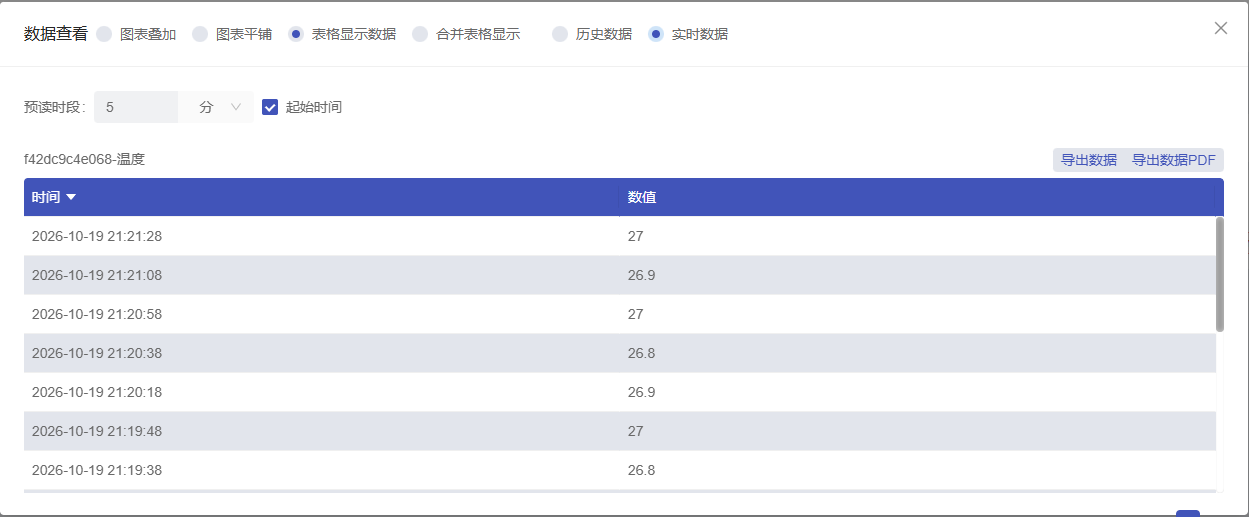

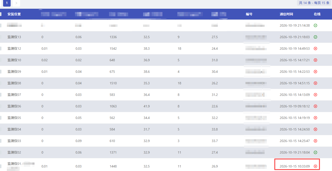

其他设备（行），能正常更新时间，显示在线。<br />
就是有一个设备，也在上数，就是通信时间始终不变（显示离线了）<br />
之前还好的，突然不行了。</p>
<p dir="auto"><img src="/assets/uploads/files/1792415968105-618cc10e-e7df-4027-b542-bdfd7abeea87-image.png" alt="618cc10e-e7df-4027-b542-bdfd7abeea87-image.png" class=" img-fluid img-markdown" /></p>

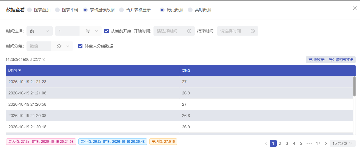

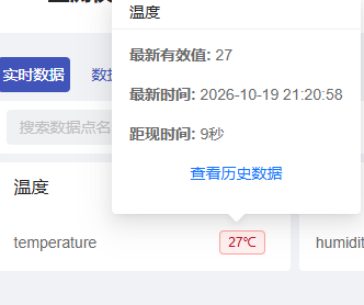

<p dir="auto">数据是会上传的。<br />
<img src="/assets/uploads/files/1792416088828-1a07ba86-7bae-4666-b1b8-55e48e1b10dc-image.png" alt="1a07ba86-7bae-4666-b1b8-55e48e1b10dc-image.png" class=" img-fluid img-markdown" /></p>
<p dir="auto"><img src="/assets/uploads/files/1792416109888-918a7322-94e6-4dd8-a97d-e9f16345b0ca-image.png" alt="918a7322-94e6-4dd8-a97d-e9f16345b0ca-image.png" class=" img-fluid img-markdown" /></p>
<p dir="auto"><img src="/assets/uploads/files/1792416120191-fa3011d4-01b4-4f52-b45b-294d03db7290-image.png" alt="fa3011d4-01b4-4f52-b45b-294d03db7290-image.png" class=" img-fluid img-markdown" /></p>

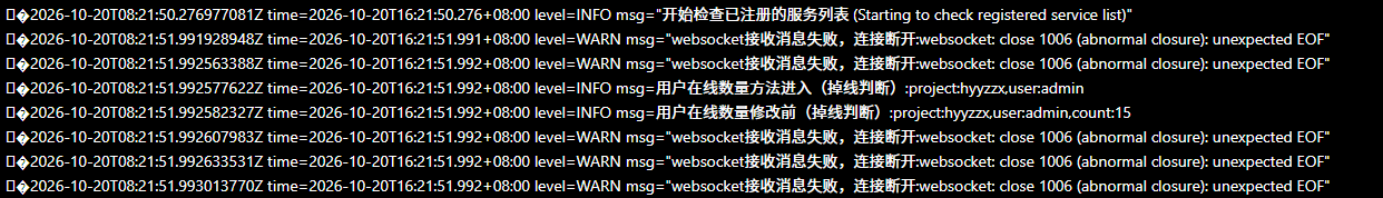

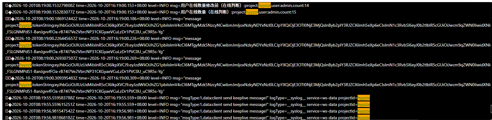

]]></description><link>https://qa.airiot.tech/post/20991</link><guid isPermaLink="true">https://qa.airiot.tech/post/20991</guid><dc:creator><![CDATA[核桃酥]]></dc:creator><pubDate>Tue, 20 Oct 2026 09:27:32 GMT</pubDate></item><item><title><![CDATA[Reply to 通信时间永远不变 on Tue, 20 Oct 2026 08:29:29 GMT]]></title><description><![CDATA[<p dir="auto">ws-data  版本 v4.1.44<br />
我是多空间版，我也不知道怎么查看“这个项目”的ws-data 日志。<br />
我大概能搜索到这些<br />
<img src="/assets/uploads/files/1792484903667-3a8f07c6-02e6-4c59-a359-af953e8d1b26-image.png" alt="image.png" class=" img-fluid img-markdown" /></p>
<p dir="auto"><img src="/assets/uploads/files/1792484954401-c6bcc7b9-c178-451e-a028-71b7618e03c6-image.png" alt="image.png" class=" img-fluid img-markdown" /></p>
