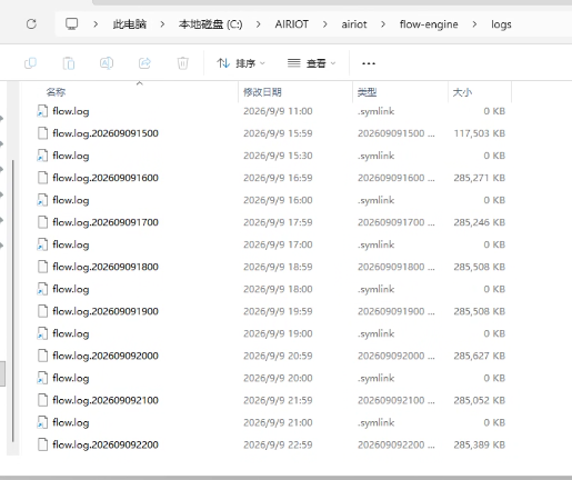

<?xml version="1.0" encoding="UTF-8"?><rss xmlns:dc="http://purl.org/dc/elements/1.1/" xmlns:content="http://purl.org/rss/1.0/modules/content/" xmlns:atom="http://www.w3.org/2005/Atom" version="2.0"><channel><title><![CDATA[磁盘异常占满，登录不了]]></title><description><![CDATA[<p dir="auto">C:\AIRIOT\airiot\flow-engine\logs这个文件209GB,应该是不正常的吧，<img src="/assets/uploads/files/1792374799122-aca6093d-c9c7-4bca-9f02-0bd0b7ce58b9-image.png" alt="aca6093d-c9c7-4bca-9f02-0bd0b7ce58b9-image.png" class=" img-fluid img-markdown" /></p>

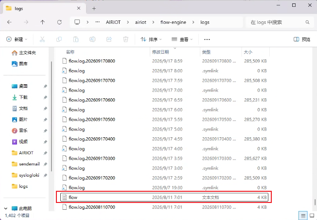

<p dir="auto"><img src="/assets/uploads/files/1792480300548-415244c4-60bf-451e-874f-a1a9b44b363b-image.png" alt="image.png" class=" img-fluid img-markdown" /></p>
]]></description><link>https://qa.airiot.tech/post/20984</link><guid isPermaLink="true">https://qa.airiot.tech/post/20984</guid><dc:creator><![CDATA[还好]]></dc:creator><pubDate>Tue, 20 Oct 2026 07:15:26 GMT</pubDate></item><item><title><![CDATA[Reply to 磁盘异常占满，登录不了 on Tue, 20 Oct 2026 07:06:18 GMT]]></title><description><![CDATA[<p dir="auto"><img src="/assets/uploads/files/1792479966898-065c5603-c901-4684-a126-ca5792bb242c-image.png" alt="image.png" class=" img-fluid img-markdown" />是这个吗，已经发送了</p>

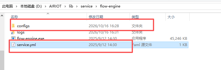

]]></description><link>https://qa.airiot.tech/post/20982</link><guid isPermaLink="true">https://qa.airiot.tech/post/20982</guid><dc:creator><![CDATA[Kk]]></dc:creator><pubDate>Tue, 20 Oct 2026 07:06:18 GMT</pubDate></item><item><title><![CDATA[Reply to 磁盘异常占满，登录不了 on Tue, 20 Oct 2026 06:30:18 GMT]]></title><description><![CDATA[<p dir="auto">停止 flow-engine 服务后删除，不过这文件这么大确实不太正常，看看flow-engine 服务配置文件，上传到这里，然后复制链接<br />
