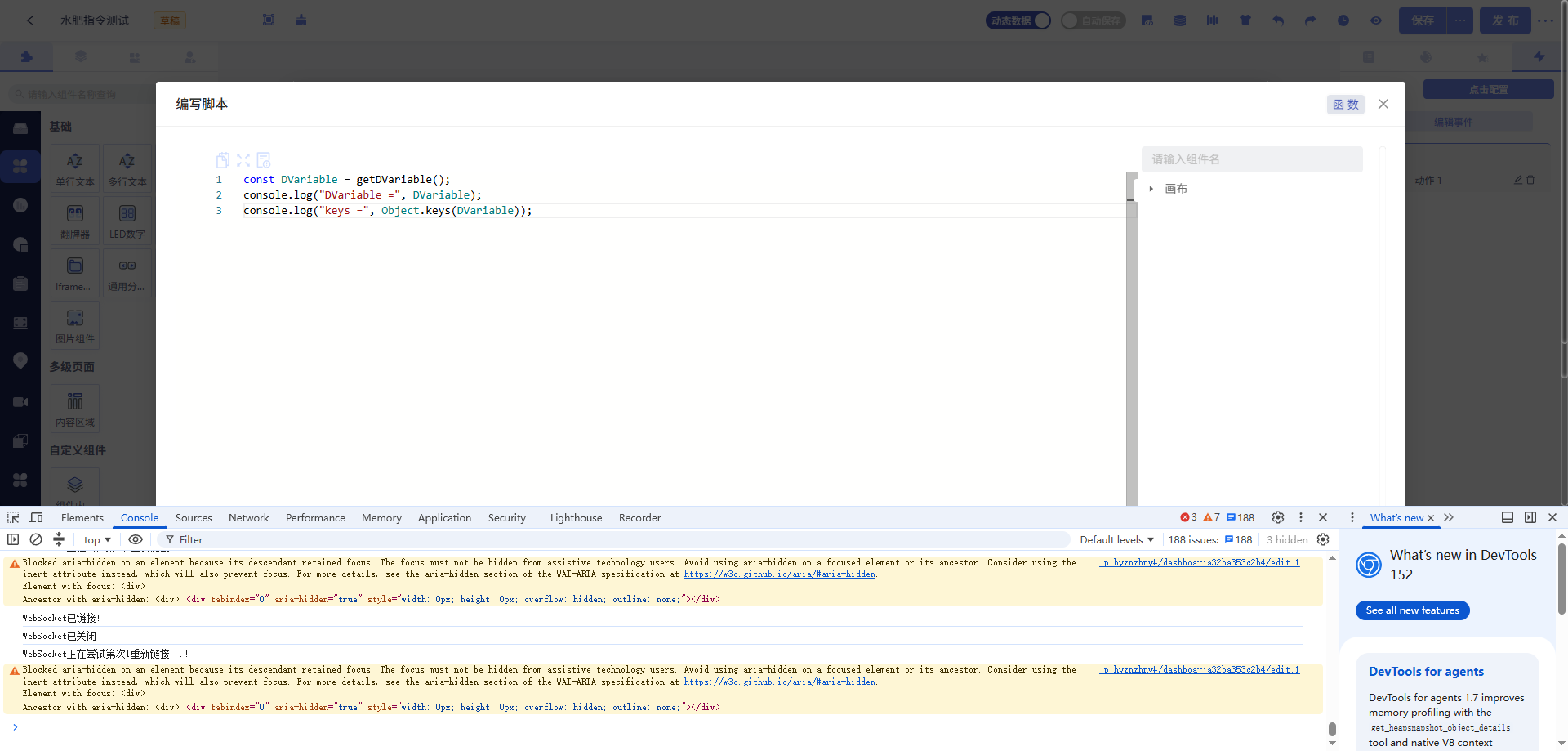

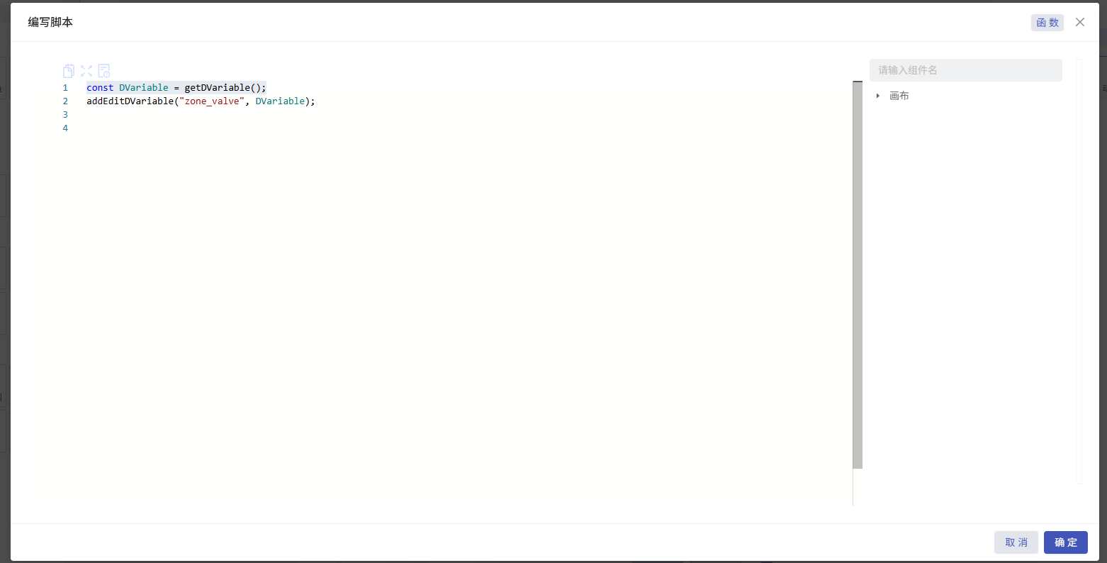

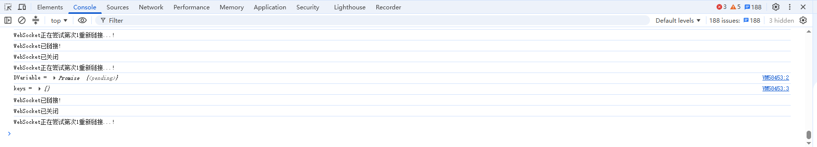

]]></description><link>https://qa.airiot.tech/topic/2857/使用脚本获取画面变量无法获取</link><generator>RSS for Node</generator><lastBuildDate>Thu, 17 Sep 2026 10:31:39 GMT</lastBuildDate><atom:link href="https://qa.airiot.tech/topic/2857.rss" rel="self" type="application/rss+xml"/><pubDate>Wed, 16 Sep 2026 09:17:57 GMT</pubDate><ttl>60</ttl><item><title><![CDATA[Reply to 使用脚本获取画面变量无法获取 on Thu, 17 Sep 2026 05:43:12 GMT]]></title><description><![CDATA[<p dir="auto"><img src="/assets/uploads/files/1789623789549-e0147fd7-748f-4154-a449-9931b6238708-image.png" alt="image.png" class=" img-fluid img-markdown" /></p>

]]></description><link>https://qa.airiot.tech/post/20819</link><guid isPermaLink="true">https://qa.airiot.tech/post/20819</guid><dc:creator><![CDATA[hk]]></dc:creator><pubDate>Thu, 17 Sep 2026 03:14:18 GMT</pubDate></item><item><title><![CDATA[Reply to 使用脚本获取画面变量无法获取 on Thu, 17 Sep 2026 01:36:03 GMT]]></title><description><![CDATA[<p dir="auto">你把DVariable打印出来看看是什么内容</p>
]]></description><link>https://qa.airiot.tech/post/20810</link><guid isPermaLink="true">https://qa.airiot.tech/post/20810</guid><dc:creator><![CDATA[核桃酥]]></dc:creator><pubDate>Thu, 17 Sep 2026 01:36:03 GMT</pubDate></item></channel></rss>
