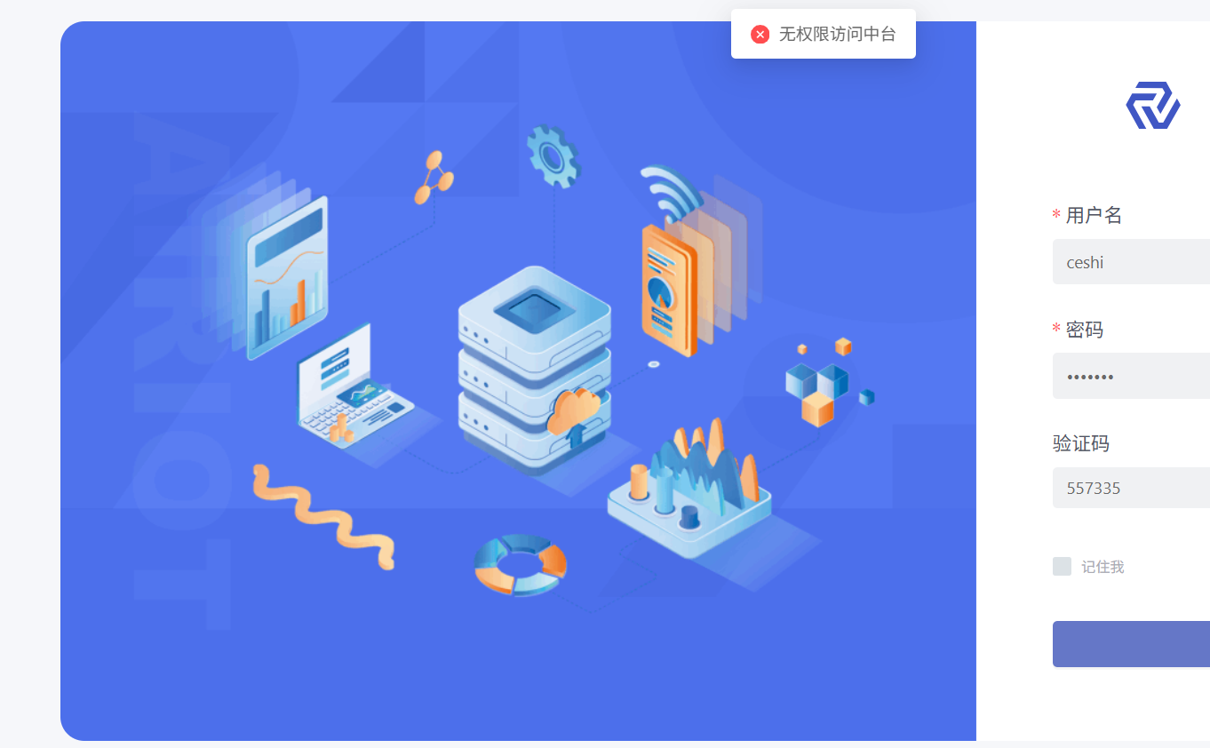

<?xml version="1.0" encoding="UTF-8"?><rss xmlns:dc="http://purl.org/dc/elements/1.1/" xmlns:content="http://purl.org/rss/1.0/modules/content/" xmlns:atom="http://www.w3.org/2005/Atom" version="2.0"><channel><title><![CDATA[新建用户无权限访问中台]]></title><description><![CDATA[<p dir="auto"><img src="/assets/uploads/files/1787218412040-bc3de78b-84eb-41a9-b50a-df3e347eb1d2-image.png" alt="bc3de78b-84eb-41a9-b50a-df3e347eb1d2-image.png" class=" img-fluid img-markdown" /><br />
新建用户，已经勾选了所有权限，登录时仍提示无权限访问中台，这个如何解决？</p>

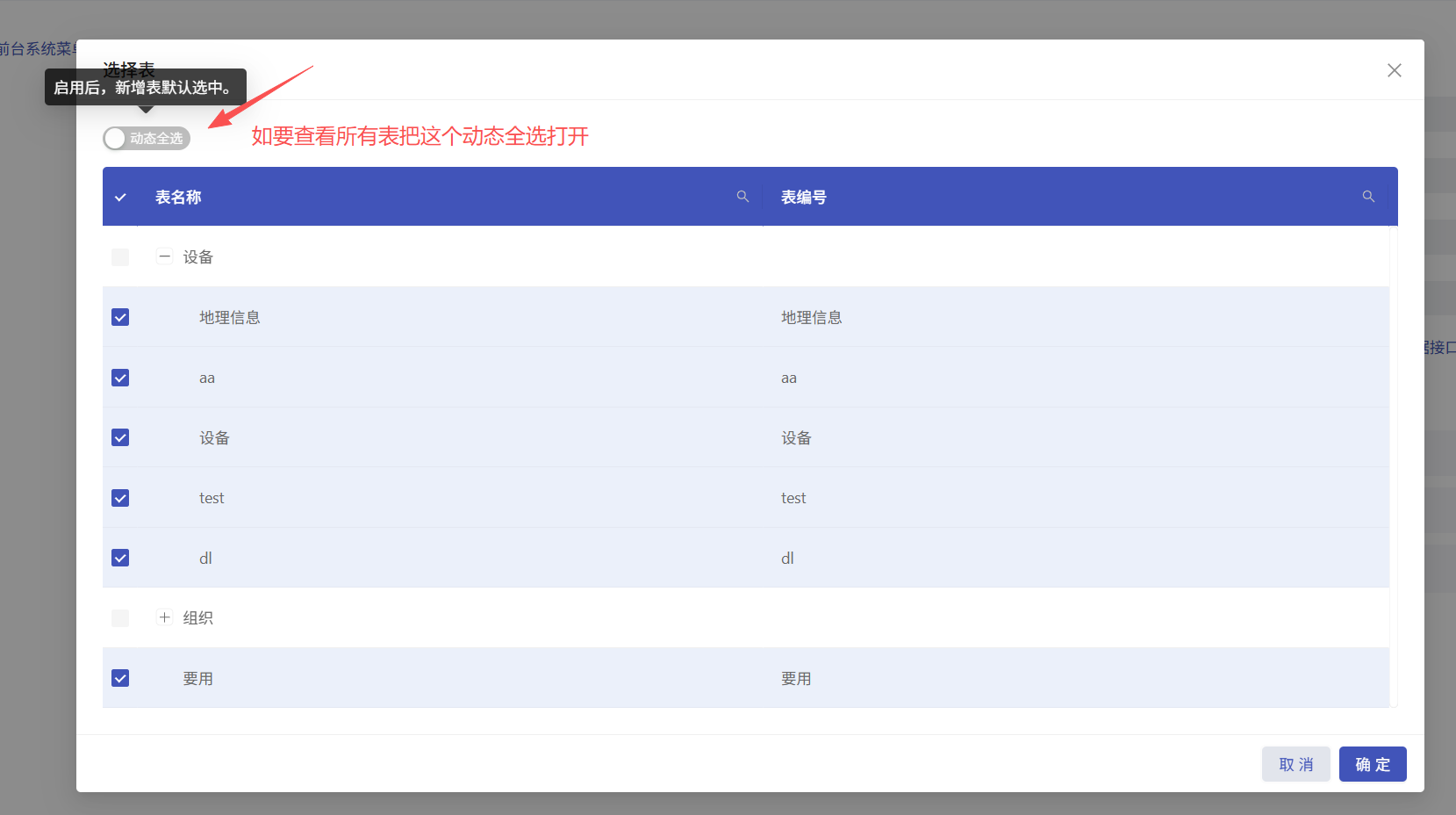

]]></description><link>https://qa.airiot.tech/topic/2820/新建用户无权限访问中台</link><generator>RSS for Node</generator><lastBuildDate>Fri, 21 Aug 2026 17:45:46 GMT</lastBuildDate><atom:link href="https://qa.airiot.tech/topic/2820.rss" rel="self" type="application/rss+xml"/><pubDate>Thu, 20 Aug 2026 09:31:50 GMT</pubDate><ttl>60</ttl><item><title><![CDATA[Reply to 新建用户无权限访问中台 on Fri, 21 Aug 2026 05:55:29 GMT]]></title><description><![CDATA[<p dir="auto"><img src="/assets/uploads/files/1787291638493-a4555a82-56dc-4c13-8770-d695d5e54997-33385cf949c1c01a4df9123e75223975.png" alt="33385cf949c1c01a4df9123e75223975.png" class=" img-fluid img-markdown" /></p>

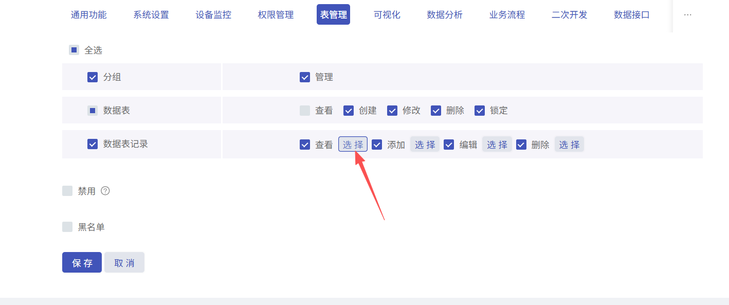

<p dir="auto"><img src="/assets/uploads/files/1787291645431-52b61e61-e5aa-4844-aef5-57c7cd38299c-d2f172a5fec0d6d485403bd00e8554f7.png" alt="d2f172a5fec0d6d485403bd00e8554f7.png" class=" img-fluid img-markdown" /><br />
点这个查看后边的选择，如果是想查看部分表就看哪个勾选哪个，如果是想查看全部表就全选，然后再把动态全选打开</p>

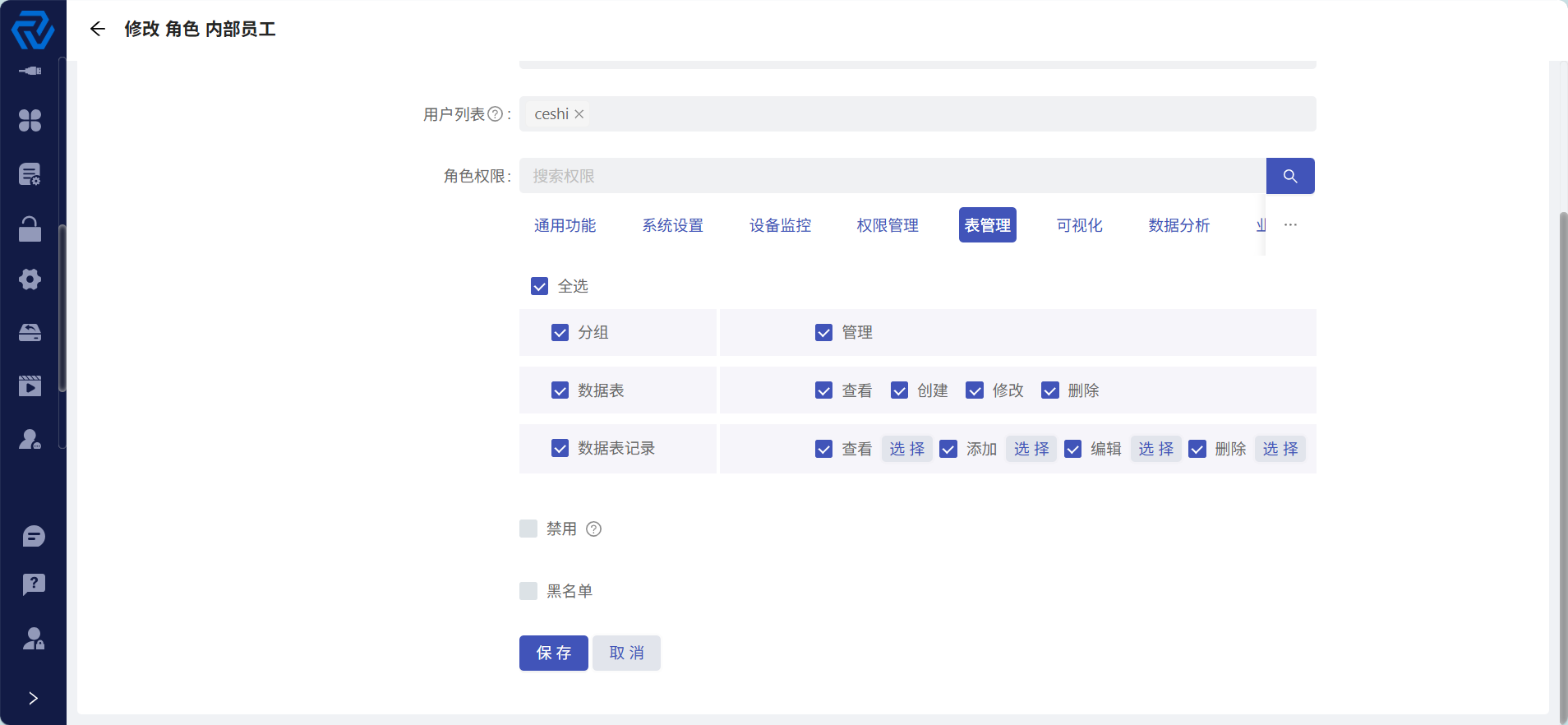

]]></description><link>https://qa.airiot.tech/post/20624</link><guid isPermaLink="true">https://qa.airiot.tech/post/20624</guid><dc:creator><![CDATA[hp]]></dc:creator><pubDate>Fri, 21 Aug 2026 05:55:29 GMT</pubDate></item><item><title><![CDATA[Reply to 新建用户无权限访问中台 on Fri, 21 Aug 2026 03:55:24 GMT]]></title><description><![CDATA[<p dir="auto"><img src="/assets/uploads/files/1787284499038-58b36e8d-32d9-41db-857f-be9e7d6aee8e-image.png" alt="image.png" class=" img-fluid img-markdown" /><br />
我勾选了查看表的，结果进入之后只有文件夹，没看到表</p>

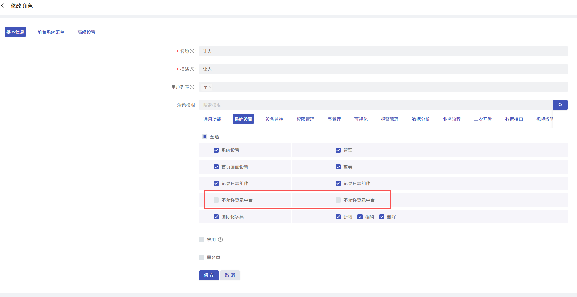

]]></description><link>https://qa.airiot.tech/post/20621</link><guid isPermaLink="true">https://qa.airiot.tech/post/20621</guid><dc:creator><![CDATA[faith]]></dc:creator><pubDate>Fri, 21 Aug 2026 03:53:19 GMT</pubDate></item><item><title><![CDATA[Reply to 新建用户无权限访问中台 on Thu, 20 Aug 2026 09:53:54 GMT]]></title><description><![CDATA[<p dir="auto"><img src="/assets/uploads/files/1787219602885-59d24f16-4a90-4866-9a65-03d4b6ea749a-image.png" alt="image.png" class=" img-fluid img-markdown" />看下权限里这个是否勾选了，如果勾选了要取消掉</p>
