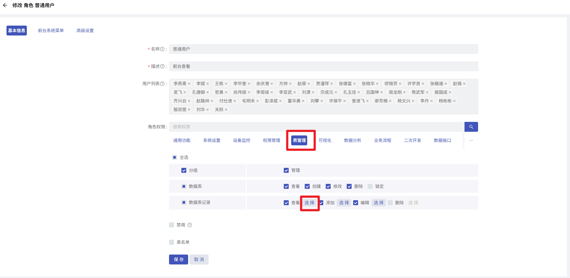

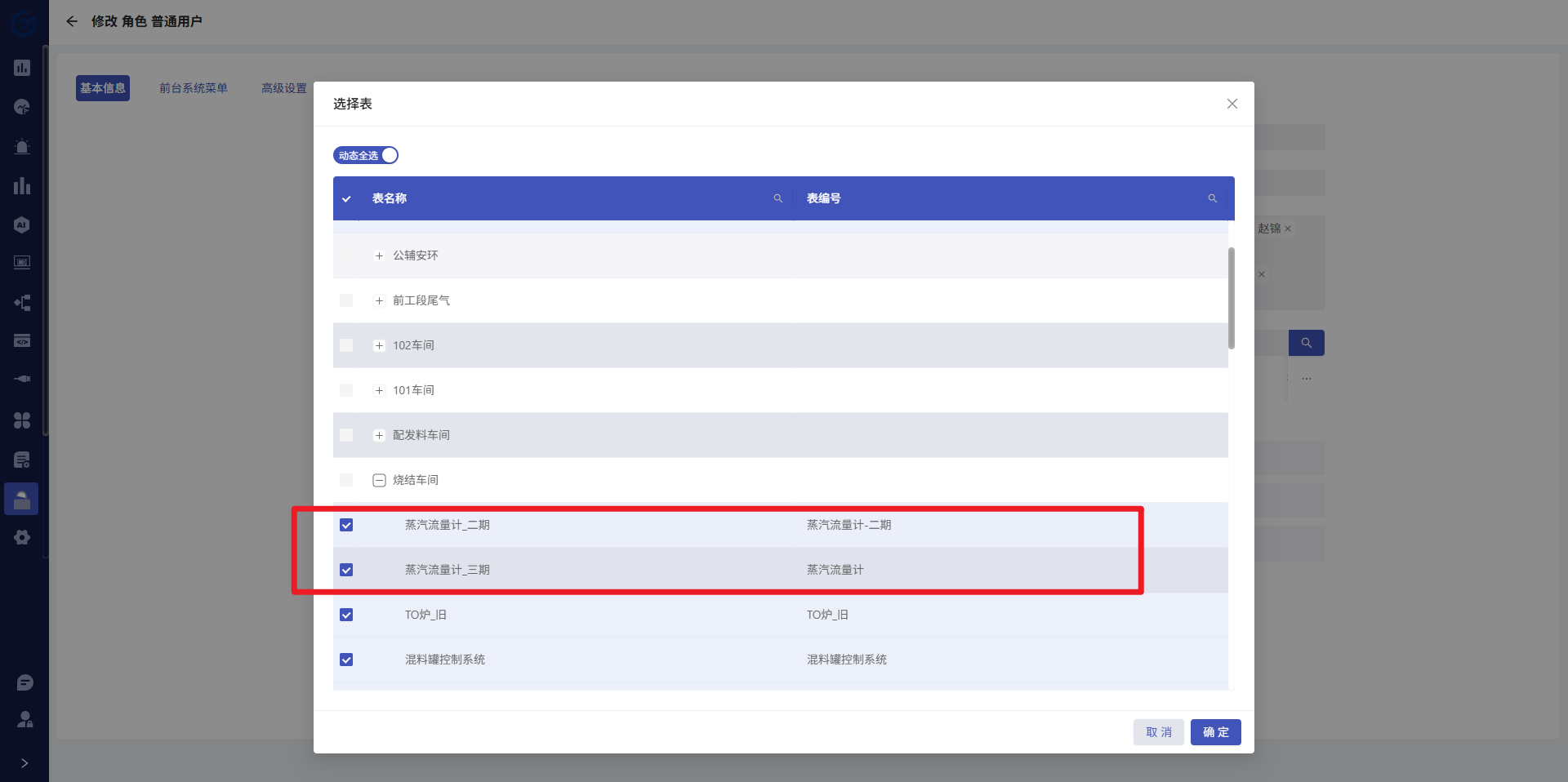

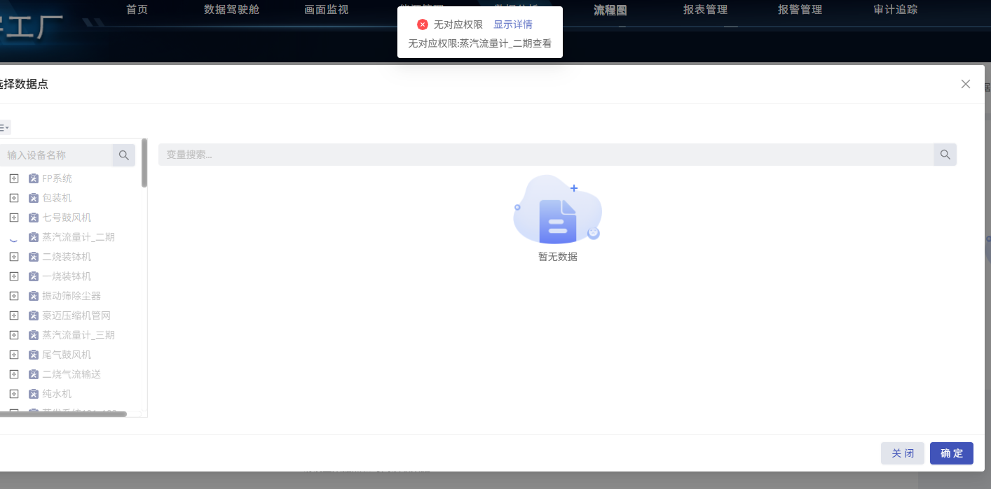

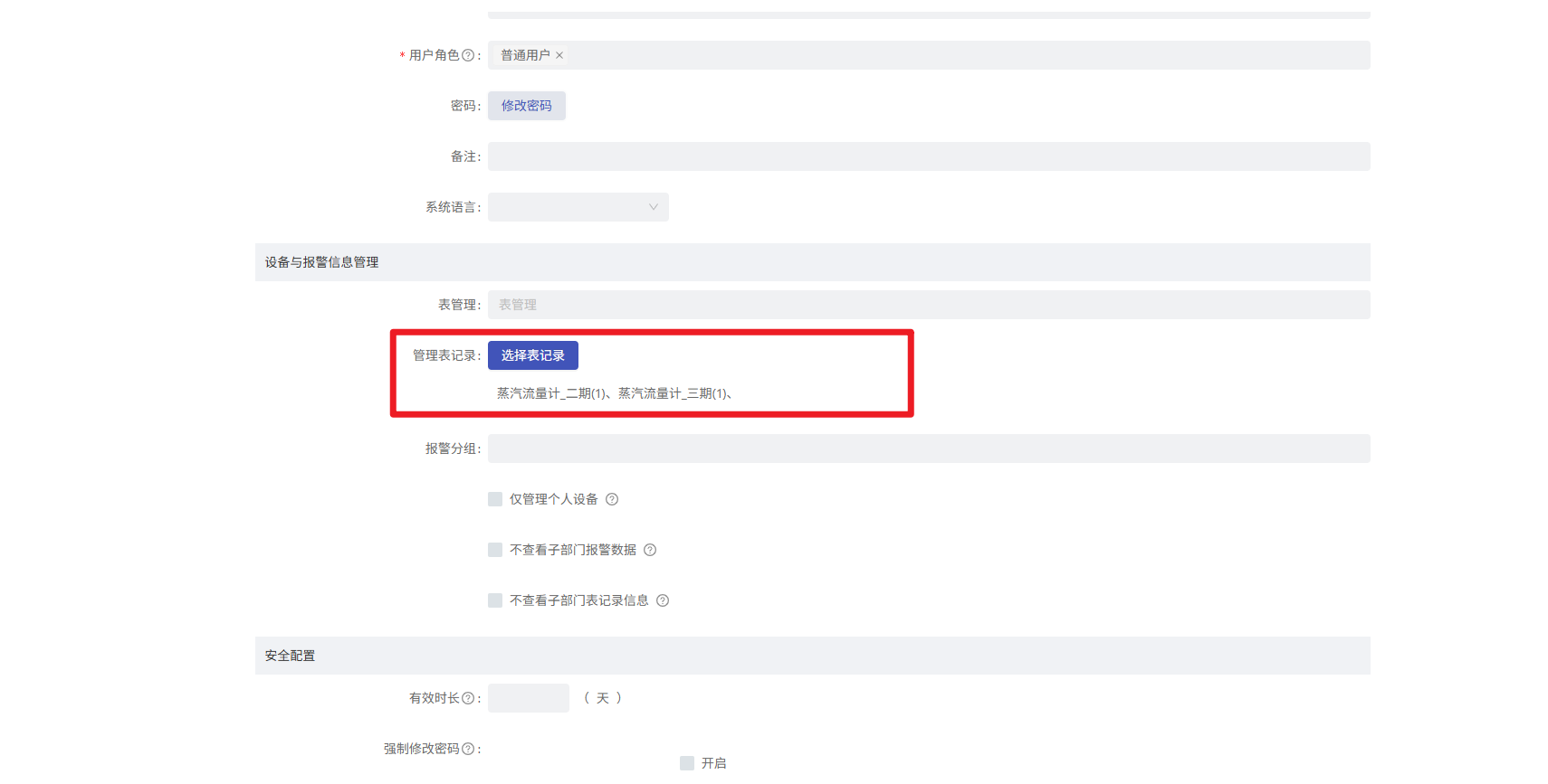

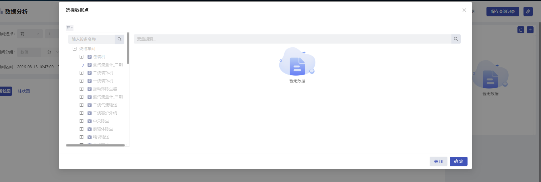

<?xml version="1.0" encoding="UTF-8"?><rss xmlns:dc="http://purl.org/dc/elements/1.1/" xmlns:content="http://purl.org/rss/1.0/modules/content/" xmlns:atom="http://www.w3.org/2005/Atom" version="2.0"><channel><title><![CDATA[表记录权限&#x2F;用户查看不了]]></title><description><![CDATA[<p dir="auto">给用户和用户对应的角色配置的两个表单，但是用户查看不了。其它用户使用该角色也查看不了，admin可以查看。<br />
|<img src="/assets/uploads/files/1786589602122-bc248e11-9b54-4e62-a136-b0ac746dceba-image.png" alt="bc248e11-9b54-4e62-a136-b0ac746dceba-image.png" class=" img-fluid img-markdown" /><br />
<img src="/assets/uploads/files/1786589612372-c64b1a4c-3a97-4615-b805-30b6ebf3b203-image.png" alt="c64b1a4c-3a97-4615-b805-30b6ebf3b203-image.png" class=" img-fluid img-markdown" /><br />
<img src="/assets/uploads/files/1786589751960-e35757a8-4d28-4a84-b668-f1ac36646c79-image.png" alt="e35757a8-4d28-4a84-b668-f1ac36646c79-image.png" class=" img-fluid img-markdown" /><br />
<img src="/assets/uploads/files/1786589797506-d3274933-8a91-4665-a2fa-8003a9df700e-image.png" alt="d3274933-8a91-4665-a2fa-8003a9df700e-image.png" class=" img-fluid img-markdown" /></p>

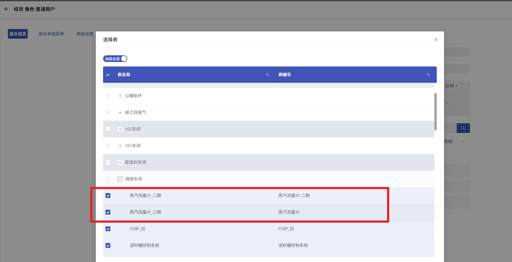

]]></description><link>https://qa.airiot.tech/topic/2810/表记录权限-用户查看不了</link><generator>RSS for Node</generator><lastBuildDate>Thu, 13 Aug 2026 18:45:30 GMT</lastBuildDate><atom:link href="https://qa.airiot.tech/topic/2810.rss" rel="self" type="application/rss+xml"/><pubDate>Thu, 13 Aug 2026 02:58:33 GMT</pubDate><ttl>60</ttl><item><title><![CDATA[Reply to 表记录权限&#x2F;用户查看不了 on Thu, 13 Aug 2026 06:53:13 GMT]]></title><description><![CDATA[<p dir="auto">取消保存后，重新勾选保存解决了，谢谢~~</p>

]]></description><link>https://qa.airiot.tech/post/20522</link><guid isPermaLink="true">https://qa.airiot.tech/post/20522</guid><dc:creator><![CDATA[hp]]></dc:creator><pubDate>Thu, 13 Aug 2026 06:47:56 GMT</pubDate></item><item><title><![CDATA[Reply to 表记录权限&#x2F;用户查看不了 on Thu, 13 Aug 2026 06:24:19 GMT]]></title><description><![CDATA[<p dir="auto">是的。截图这个是：角色--&gt;表管理（点击选择，弹窗“选择表”）--&gt;两个点位已勾选</p>
<p dir="auto"><img src="/assets/uploads/files/1786602137690-4e3ad070-5e82-46d5-b46b-fc53d96ff61d-image.png" alt="image.png" class=" img-fluid img-markdown" /></p>
<p dir="auto"><img src="/assets/uploads/files/1786602155758-66eff8e1-65e4-46cd-bf7a-6ba2c0508257-image.png" alt="image.png" class=" img-fluid img-markdown" /></p>
]]></description><link>https://qa.airiot.tech/post/20521</link><guid isPermaLink="true">https://qa.airiot.tech/post/20521</guid><dc:creator><![CDATA[ggzn]]></dc:creator><pubDate>Thu, 13 Aug 2026 06:24:19 GMT</pubDate></item><item><title><![CDATA[Reply to 表记录权限&#x2F;用户查看不了 on Thu, 13 Aug 2026 06:05:48 GMT]]></title><description><![CDATA[<p dir="auto"><img src="/assets/uploads/files/1786601041667-54217219-d75d-4f20-92b5-4e50040bdb8e-image.png" alt="image.png" class=" img-fluid img-markdown" /><br />
你上面这个截图是查看后面的选择弹窗吗，现在看一下查看后面的选择弹窗中这个表有没有勾选</p>
]]></description><link>https://qa.airiot.tech/post/20520</link><guid isPermaLink="true">https://qa.airiot.tech/post/20520</guid><dc:creator><![CDATA[hp]]></dc:creator><pubDate>Thu, 13 Aug 2026 06:05:48 GMT</pubDate></item><item><title><![CDATA[Reply to 表记录权限&#x2F;用户查看不了 on Thu, 13 Aug 2026 05:36:21 GMT]]></title><description><![CDATA[<p dir="auto">报错是这样~</p>

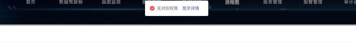

<p dir="auto"><img src="/assets/uploads/files/1786599379748-1b279fc2-f656-44cb-9ca3-2bf81914669b-image.png" alt="image.png" class=" img-fluid img-markdown" /></p>
]]></description><link>https://qa.airiot.tech/post/20519</link><guid isPermaLink="true">https://qa.airiot.tech/post/20519</guid><dc:creator><![CDATA[ggzn]]></dc:creator><pubDate>Thu, 13 Aug 2026 05:36:21 GMT</pubDate></item><item><title><![CDATA[Reply to 表记录权限&#x2F;用户查看不了 on Thu, 13 Aug 2026 03:36:19 GMT]]></title><description><![CDATA[<p dir="auto">无对应权限后边显示详情展开看一下报错</p>
]]></description><link>https://qa.airiot.tech/post/20518</link><guid isPermaLink="true">https://qa.airiot.tech/post/20518</guid><dc:creator><![CDATA[hp]]></dc:creator><pubDate>Thu, 13 Aug 2026 03:36:19 GMT</pubDate></item></channel></rss>
