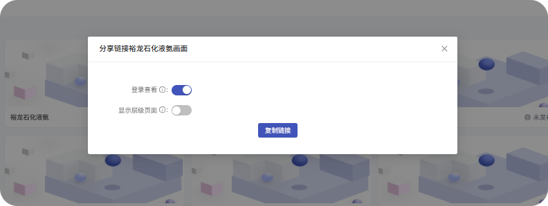

<?xml version="1.0" encoding="UTF-8"?><rss xmlns:dc="http://purl.org/dc/elements/1.1/" xmlns:content="http://purl.org/rss/1.0/modules/content/" xmlns:atom="http://www.w3.org/2005/Atom" version="2.0"><channel><title><![CDATA[有长期token吗]]></title><description><![CDATA[<p dir="auto"><img src="/assets/uploads/files/1786413536524-553045b5-41ee-455d-b670-6e9d1ea1a611-d2cb9efe63fad7a81103b4e0d3f73910.png" alt="553045b5-41ee-455d-b670-6e9d1ea1a611-d2cb9efe63fad7a81103b4e0d3f73910.png" class=" img-fluid img-markdown" /> 目前多处登录不上去都过期了</p>

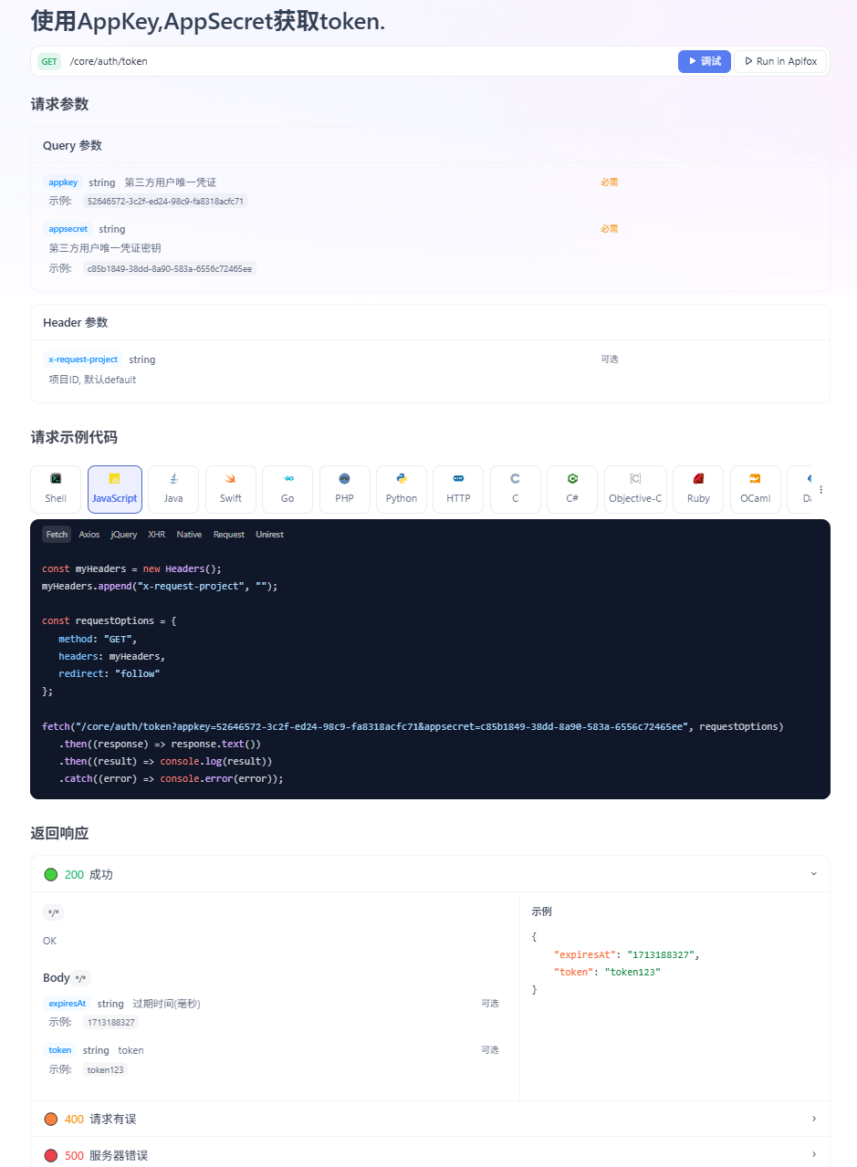

<img src="/assets/uploads/files/1786516279388-6a88d9bf-3303-4380-a943-3de466c7454f-image.png" alt="image.png" class=" img-fluid img-markdown" /></p>

]]></description><link>https://qa.airiot.tech/post/20513</link><guid isPermaLink="true">https://qa.airiot.tech/post/20513</guid><dc:creator><![CDATA[ggzn_chp]]></dc:creator><pubDate>Tue, 11 Aug 2026 08:20:29 GMT</pubDate></item><item><title><![CDATA[Reply to 有长期token吗 on Tue, 11 Aug 2026 06:12:51 GMT]]></title><description><![CDATA[<p dir="auto">登录查看关闭一下就有了</p>
]]></description><link>https://qa.airiot.tech/post/20512</link><guid isPermaLink="true">https://qa.airiot.tech/post/20512</guid><dc:creator><![CDATA[hp]]></dc:creator><pubDate>Tue, 11 Aug 2026 06:12:51 GMT</pubDate></item><item><title><![CDATA[Reply to 有长期token吗 on Tue, 11 Aug 2026 06:10:12 GMT]]></title><description><![CDATA[<p dir="auto"><img src="/assets/uploads/files/1786428460419-932bf75f-087a-466f-b094-c8299e7bf0cc-pixpin_2026-08-11_14-07-31.png" alt="PixPin_2026-08-11_14-07-31.png" class=" img-fluid img-markdown" />只有这些配置，没有时长，这个是4.0版本的</p>

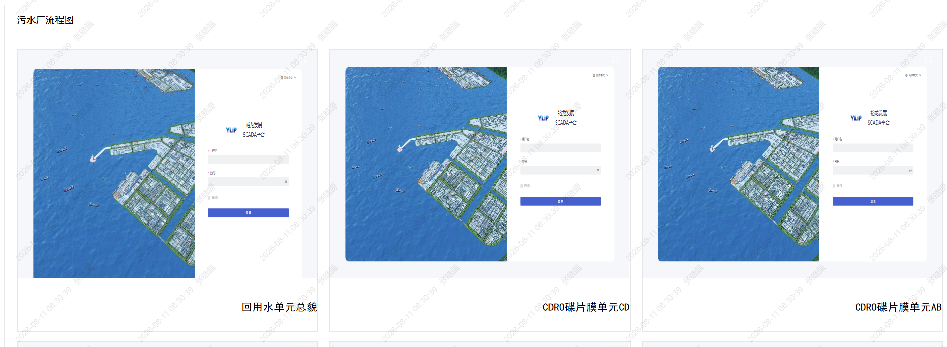

]]></description><link>https://qa.airiot.tech/post/20511</link><guid isPermaLink="true">https://qa.airiot.tech/post/20511</guid><dc:creator><![CDATA[ggzn_chp]]></dc:creator><pubDate>Tue, 11 Aug 2026 06:10:12 GMT</pubDate></item><item><title><![CDATA[Reply to 有长期token吗 on Tue, 11 Aug 2026 05:35:43 GMT]]></title><description><![CDATA[<p dir="auto">这里可以配置时间的<br />

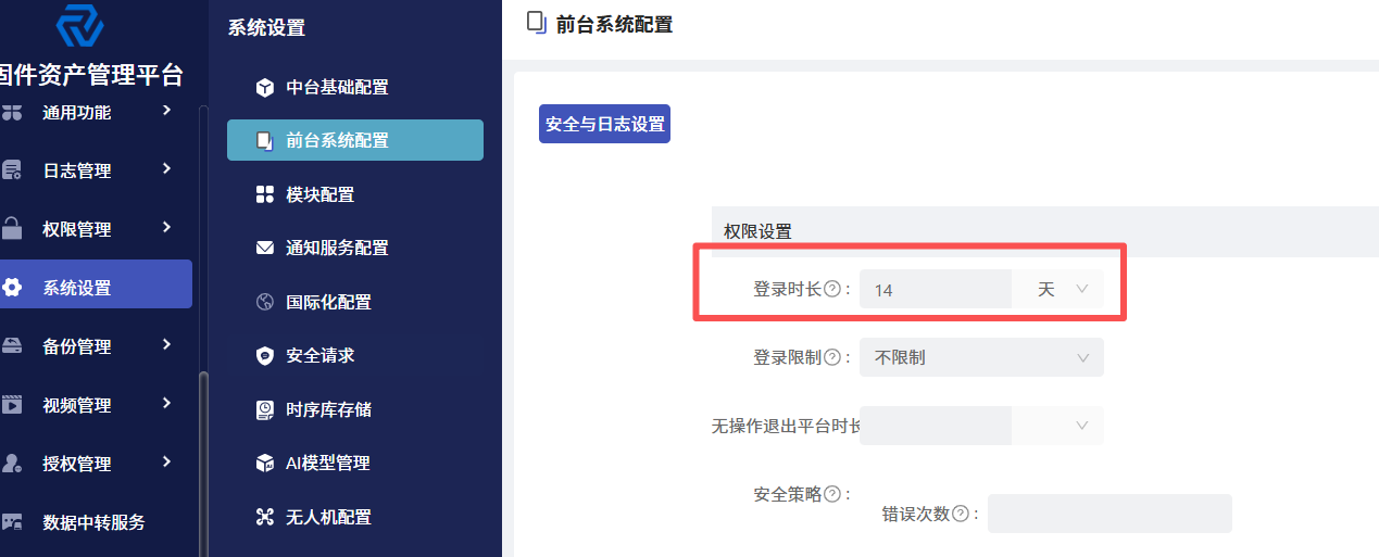

<img src="/assets/uploads/files/1786426535324-67e1690d-629d-447d-8c1d-17a54321e48e-image-resized.png" alt="image.png" class=" img-fluid img-markdown" /></p>
