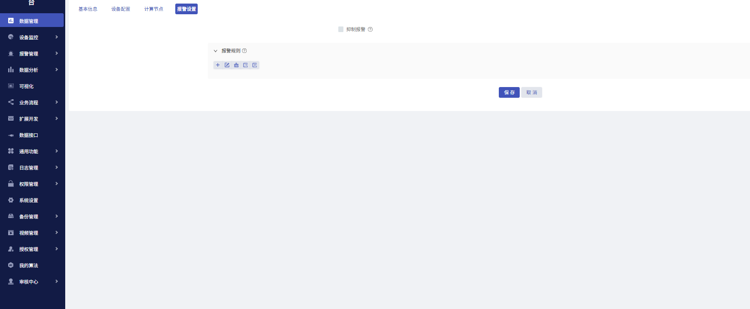

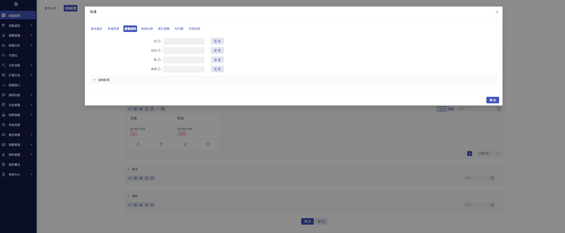

<?xml version="1.0" encoding="UTF-8"?><rss xmlns:dc="http://purl.org/dc/elements/1.1/" xmlns:content="http://purl.org/rss/1.0/modules/content/" xmlns:atom="http://www.w3.org/2005/Atom" version="2.0"><channel><title><![CDATA[报警配置规则]]></title><description><![CDATA[<p dir="auto"><img src="/assets/uploads/files/1785977970046-a179bb42-2ecb-4b5c-9151-9c23169931c7-image.png" alt="a179bb42-2ecb-4b5c-9151-9c23169931c7-image.png" class=" img-fluid img-markdown" /> <img src="/assets/uploads/files/1785977981952-56d873de-e86a-46de-8359-97db46d59ada-image.png" alt="56d873de-e86a-46de-8359-97db46d59ada-image.png" class=" img-fluid img-markdown" /> 这两个报警规则有什么区别吗</p>

]]></description><link>https://qa.airiot.tech/post/20461</link><guid isPermaLink="true">https://qa.airiot.tech/post/20461</guid><dc:creator><![CDATA[hp]]></dc:creator><pubDate>Thu, 06 Aug 2026 07:25:16 GMT</pubDate></item><item><title><![CDATA[Reply to 报警配置规则 on Thu, 06 Aug 2026 03:53:52 GMT]]></title><description><![CDATA[<p dir="auto">就是改了规则，报警通知确认后还是会一直通知</p>

报警通知是指语音播报吗，现在还在一直通知吗</p>
