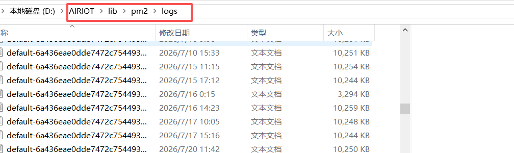

<img src="/assets/uploads/files/1785738889635-6a5ff06c-c4f6-4741-b502-df8f5a0e002a-image.png" alt="image.png" class=" img-fluid img-markdown" /></p>

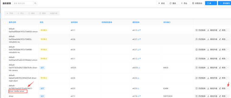

<img src="/assets/uploads/files/1785728457380-162c7d4e-1cf2-4eae-aabd-0a6daedade93-image-resized.png" alt="image.png" class=" img-fluid img-markdown" /></p>
