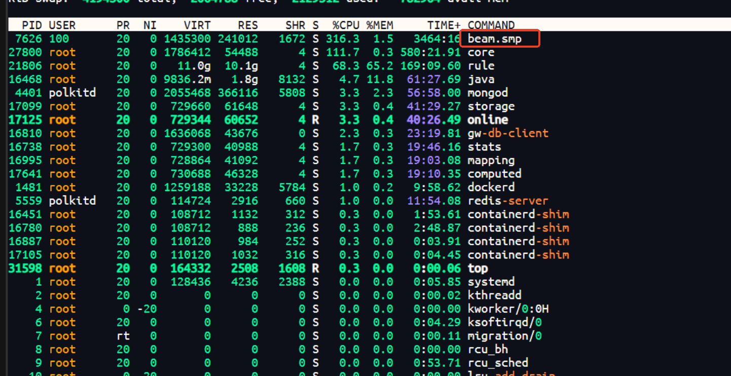

<?xml version="1.0" encoding="UTF-8"?><rss xmlns:dc="http://purl.org/dc/elements/1.1/" xmlns:content="http://purl.org/rss/1.0/modules/content/" xmlns:atom="http://www.w3.org/2005/Atom" version="2.0"><channel><title><![CDATA[beam.smp这个进程是属于那个服务的]]></title><description><![CDATA[<p dir="auto"><img src="/assets/uploads/files/1785122116132-72517791-db05-4613-8747-16584954e0ff-lqlpkd91_bxyn5pnaubnbakwbdfiozoflrekogjga9-zaa_1442_742.png" alt="72517791-db05-4613-8747-16584954e0ff-lQLPKd91_BXYN5PNAubNBaKwBDfiOzOFLREKOgJgA9-ZAA_1442_742.png" class=" img-fluid img-markdown" /></p>

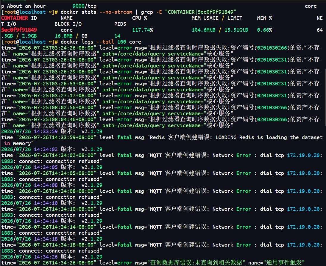

]]></description><link>https://qa.airiot.tech/post/20315</link><guid isPermaLink="true">https://qa.airiot.tech/post/20315</guid><dc:creator><![CDATA[liyitao12]]></dc:creator><pubDate>Mon, 27 Jul 2026 08:34:06 GMT</pubDate></item><item><title><![CDATA[Reply to beam.smp这个进程是属于那个服务的 on Mon, 27 Jul 2026 08:33:46 GMT]]></title><description><![CDATA[<p dir="auto"><img src="/assets/uploads/files/1785141225020-85fe5d97-d12a-4156-83db-bd4e2fca5f87-lqlpkewvczk77ppna3lnbpowgfjvsqryw8wkokr06_pfaa_1683_882.png" alt="lQLPKeWVCzK77pPNA3LNBpOwGfjvSqrYW8wKOkr06_PFAA_1683_882.png" class=" img-fluid img-markdown" /></p>
]]></description><link>https://qa.airiot.tech/post/20314</link><guid isPermaLink="true">https://qa.airiot.tech/post/20314</guid><dc:creator><![CDATA[liyitao12]]></dc:creator><pubDate>Mon, 27 Jul 2026 08:33:46 GMT</pubDate></item><item><title><![CDATA[Reply to beam.smp这个进程是属于那个服务的 on Mon, 27 Jul 2026 07:46:53 GMT]]></title><description><![CDATA[<p dir="auto">你采集的数据是不是很多，可以用mqttbox 订阅一下data/# 或者 #   看看是不是数据多造成的</p>

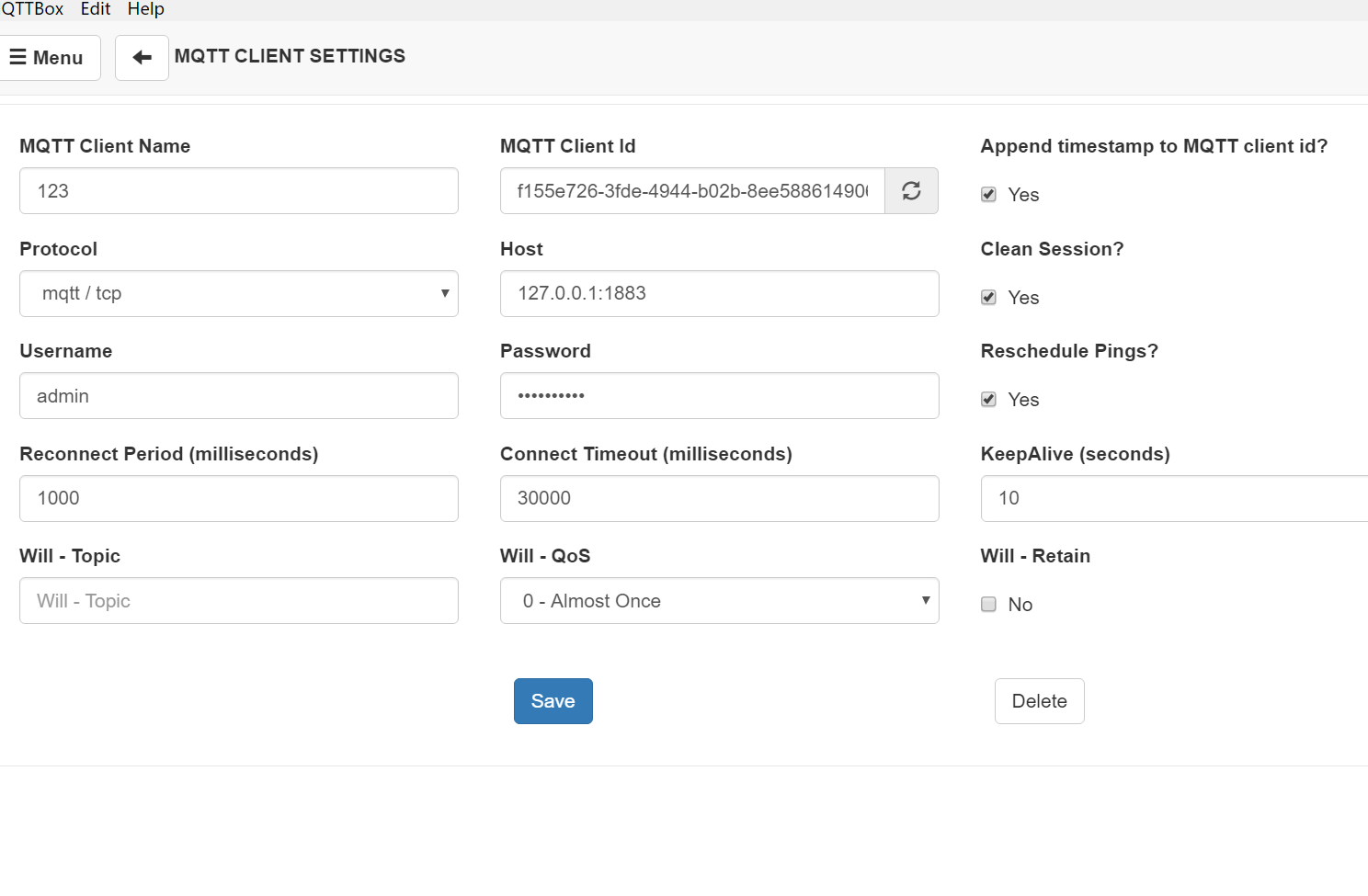

]]></description><link>https://qa.airiot.tech/post/20313</link><guid isPermaLink="true">https://qa.airiot.tech/post/20313</guid><dc:creator><![CDATA[核桃酥]]></dc:creator><pubDate>Mon, 27 Jul 2026 07:46:53 GMT</pubDate></item><item><title><![CDATA[Reply to beam.smp这个进程是属于那个服务的 on Mon, 27 Jul 2026 07:13:34 GMT]]></title><description><![CDATA[<p dir="auto">限制CPU占用率太高了，已经报警了需要怎么处理呢</p>

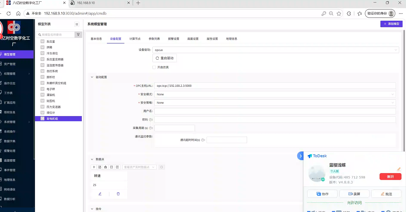

]]></description><link>https://qa.airiot.tech/post/20311</link><guid isPermaLink="true">https://qa.airiot.tech/post/20311</guid><dc:creator><![CDATA[liyitao12]]></dc:creator><pubDate>Mon, 27 Jul 2026 07:13:34 GMT</pubDate></item><item><title><![CDATA[Reply to beam.smp这个进程是属于那个服务的 on Mon, 27 Jul 2026 07:12:56 GMT]]></title><description><![CDATA[<p dir="auto"><img src="/assets/uploads/files/1785136370580-d7300777-6221-4587-b4b4-b9aa32c31ad4-lqdpkh1bxnokr8pna3vnbeewuix35c-tpj8kojd1ifgoaa_1095_891.jpg" alt="lQDPKH1BXNOkr8PNA3vNBEewuix35C-tPj8KOjd1IfgOAA_1095_891.jpg" class=" img-fluid img-markdown" /></p>
]]></description><link>https://qa.airiot.tech/post/20310</link><guid isPermaLink="true">https://qa.airiot.tech/post/20310</guid><dc:creator><![CDATA[liyitao12]]></dc:creator><pubDate>Mon, 27 Jul 2026 07:12:56 GMT</pubDate></item><item><title><![CDATA[Reply to beam.smp这个进程是属于那个服务的 on Mon, 27 Jul 2026 05:53:57 GMT]]></title><description><![CDATA[<p dir="auto">这个是消息队列@liyitao12</p>
]]></description><link>https://qa.airiot.tech/post/20305</link><guid isPermaLink="true">https://qa.airiot.tech/post/20305</guid><dc:creator><![CDATA[核桃酥]]></dc:creator><pubDate>Mon, 27 Jul 2026 05:53:57 GMT</pubDate></item></channel></rss>
