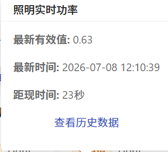

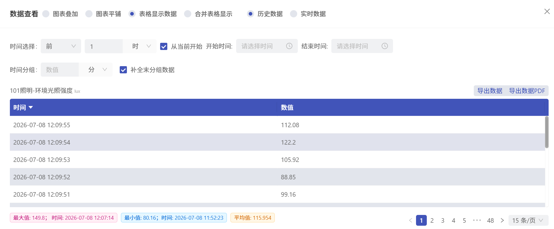

<?xml version="1.0" encoding="UTF-8"?><rss xmlns:dc="http://purl.org/dc/elements/1.1/" xmlns:content="http://purl.org/rss/1.0/modules/content/" xmlns:atom="http://www.w3.org/2005/Atom" version="2.0"><channel><title><![CDATA[计算节点无法实时更新]]></title><description><![CDATA[<p dir="auto"><img src="/assets/uploads/files/1783415190515-9c530391-f941-4568-8b54-d04843f8b4b3-image.png" alt="9c530391-f941-4568-8b54-d04843f8b4b3-image.png" class=" img-fluid img-markdown" />   <img src="/assets/uploads/files/1783415226814-e91ea451-4eed-48de-a749-a314aa09bbe0-image.png" alt="e91ea451-4eed-48de-a749-a314aa09bbe0-image.png" class=" img-fluid img-markdown" /> 环境光照强度是一直实时更新的 计算节点一直延时两分半左右</p>

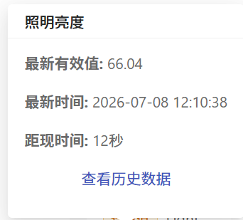

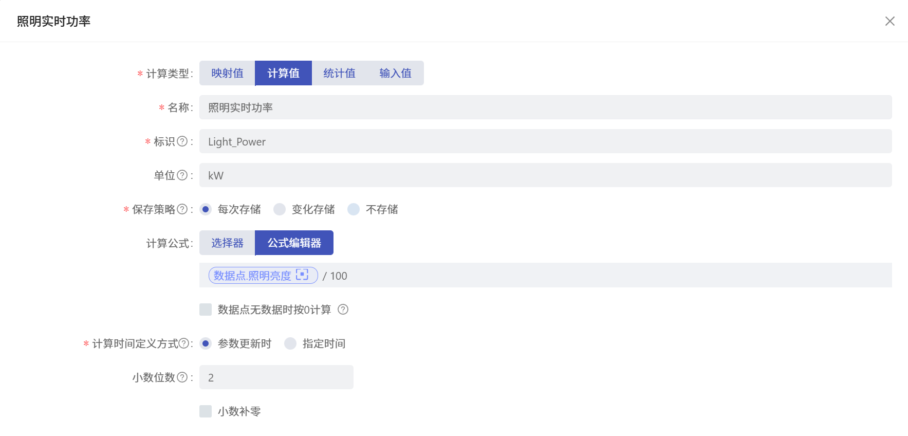

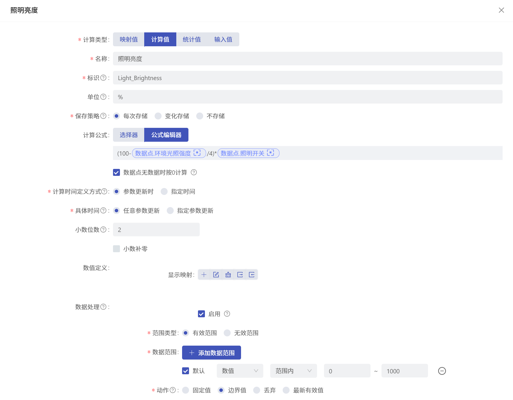

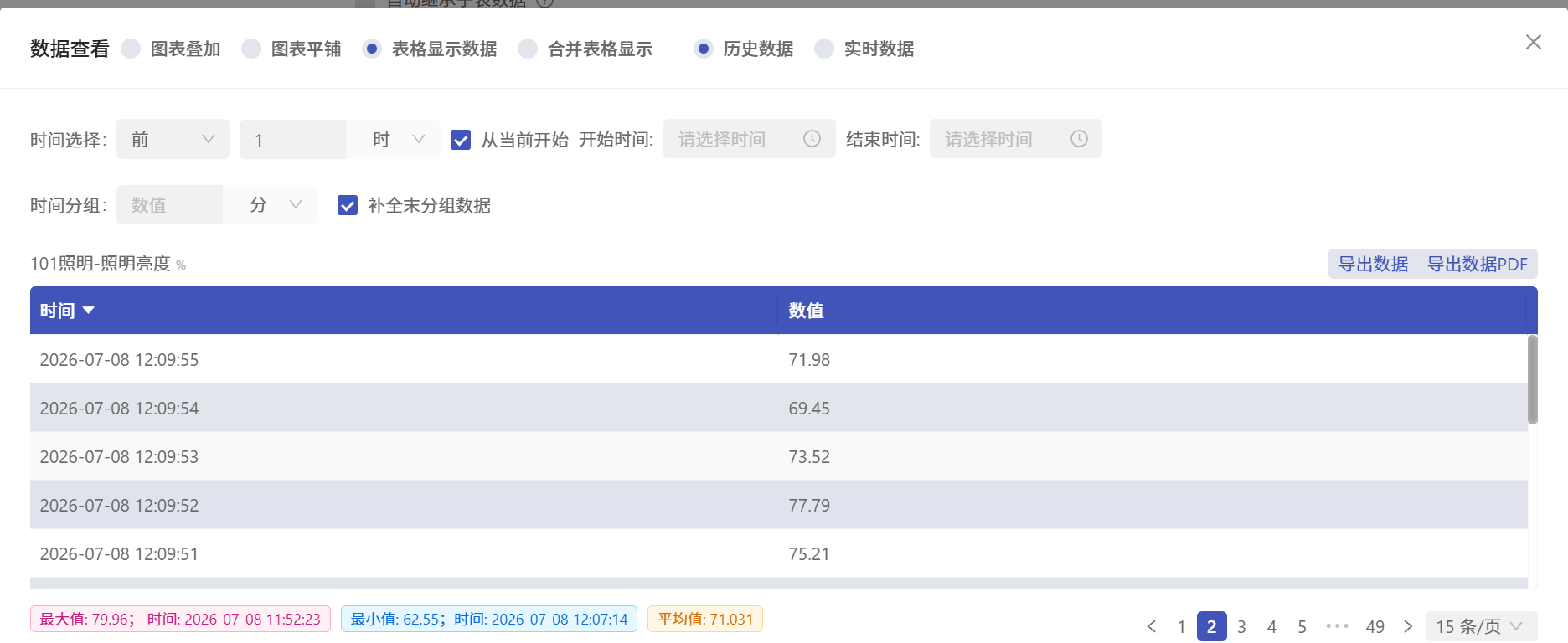

]]></description><link>https://qa.airiot.tech/post/20148</link><guid isPermaLink="true">https://qa.airiot.tech/post/20148</guid><dc:creator><![CDATA[hp]]></dc:creator><pubDate>Wed, 08 Jul 2026 08:33:16 GMT</pubDate></item><item><title><![CDATA[Reply to 计算节点无法实时更新 on Wed, 08 Jul 2026 04:12:55 GMT]]></title><description><![CDATA[<p dir="auto"><a class="plugin-mentions-user plugin-mentions-a" href="https://qa.airiot.tech/uid/376">@hp</a> <img src="/assets/uploads/files/1783483708111-a8fd5a8a-0aac-4634-9ce7-638a6dfe0a6c-image-resized.png" alt="a8fd5a8a-0aac-4634-9ce7-638a6dfe0a6c-image.png" class=" img-fluid img-markdown" /> <img src="/assets/uploads/files/1783483811349-2dc1fe6a-cdff-49c8-bbea-e2b093915e9d-image.png" alt="2dc1fe6a-cdff-49c8-bbea-e2b093915e9d-image.png" class=" img-fluid img-markdown" /> <img src="/assets/uploads/files/1783483835172-d16505f2-b8af-40fb-a83d-edbdfd0ecc6f-image.png" alt="d16505f2-b8af-40fb-a83d-edbdfd0ecc6f-image.png" class=" img-fluid img-markdown" /> <img src="/assets/uploads/files/1783483863886-0ce8f427-6f35-4c8b-bca7-97dc63c08ed0-image.png" alt="0ce8f427-6f35-4c8b-bca7-97dc63c08ed0-image.png" class=" img-fluid img-markdown" /> <img src="/assets/uploads/files/1783483873555-89b952a0-fe0e-4e61-9124-d1d357501da7-image.png" alt="89b952a0-fe0e-4e61-9124-d1d357501da7-image.png" class=" img-fluid img-markdown" /> <img src="/assets/uploads/files/1783483888186-39ce0062-b4e9-498c-b176-e4f7e91e0fef-image.png" alt="39ce0062-b4e9-498c-b176-e4f7e91e0fef-image.png" class=" img-fluid img-markdown" /> core服务更新后仍有少量延迟 另外实时功率节点也存在延迟 延迟约为亮度节点的2倍</p>
]]></description><link>https://qa.airiot.tech/post/20138</link><guid isPermaLink="true">https://qa.airiot.tech/post/20138</guid><dc:creator><![CDATA[魔想志津香]]></dc:creator><pubDate>Wed, 08 Jul 2026 04:12:55 GMT</pubDate></item><item><title><![CDATA[Reply to 计算节点无法实时更新 on Wed, 08 Jul 2026 02:33:39 GMT]]></title><description><![CDATA[<p dir="auto">core和computed服务是最新的吗，两个数据点以及计算节点的历史数据表格展示截图下</p>
