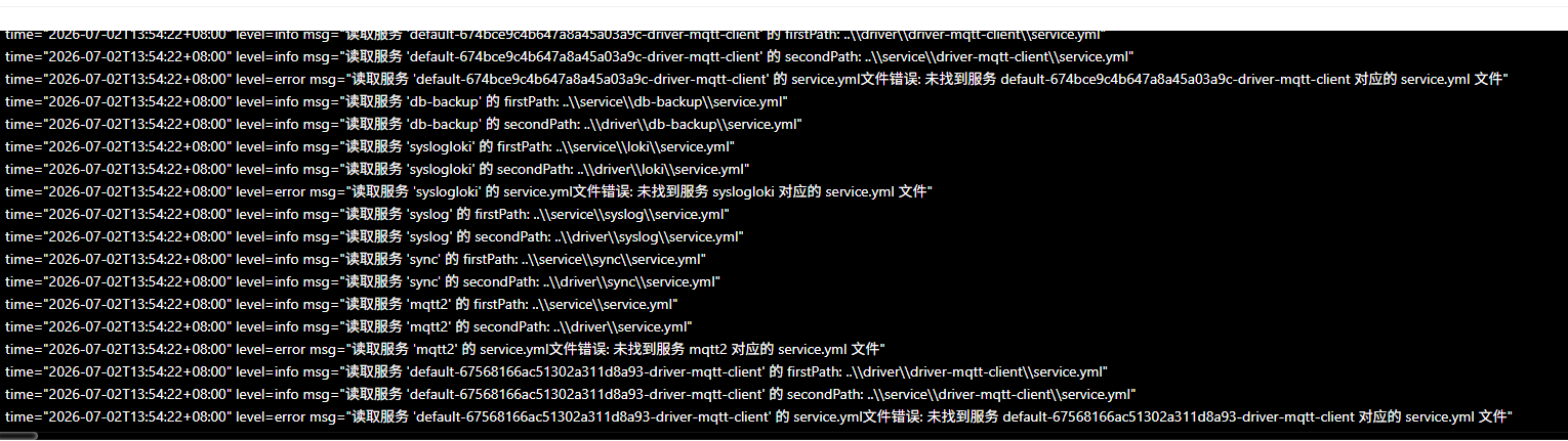

]]></description><link>https://qa.airiot.tech/post/20103</link><guid isPermaLink="true">https://qa.airiot.tech/post/20103</guid><dc:creator><![CDATA[hp]]></dc:creator><pubDate>Thu, 02 Jul 2026 06:09:09 GMT</pubDate></item><item><title><![CDATA[Reply to gb28181驱动全掉了 重启无法解决 on Thu, 02 Jul 2026 05:56:14 GMT]]></title><description><![CDATA[<p dir="auto"><a class="plugin-mentions-user plugin-mentions-a" href="https://qa.airiot.tech/uid/376">@hp</a> 这个在哪看呢 看运维里video模块的日志吗</p>
]]></description><link>https://qa.airiot.tech/post/20100</link><guid isPermaLink="true">https://qa.airiot.tech/post/20100</guid><dc:creator><![CDATA[henryyzh]]></dc:creator><pubDate>Thu, 02 Jul 2026 05:56:14 GMT</pubDate></item><item><title><![CDATA[Reply to gb28181驱动全掉了 重启无法解决 on Thu, 02 Jul 2026 05:54:52 GMT]]></title><description><![CDATA[<p dir="auto"><a class="plugin-mentions-user plugin-mentions-a" href="https://qa.airiot.tech/uid/376">@hp</a> <img src="/assets/uploads/files/1782971690439-b800a171-a9c3-459c-a6f9-c1199836fbdd-image.png" alt="b800a171-a9c3-459c-a6f9-c1199836fbdd-image.png" class=" img-fluid img-markdown" /></p>

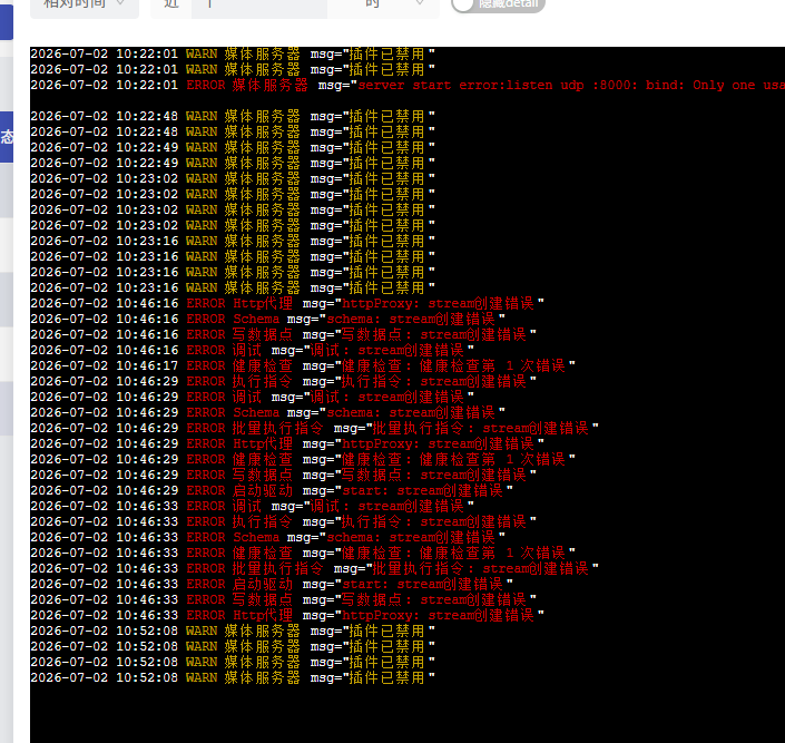

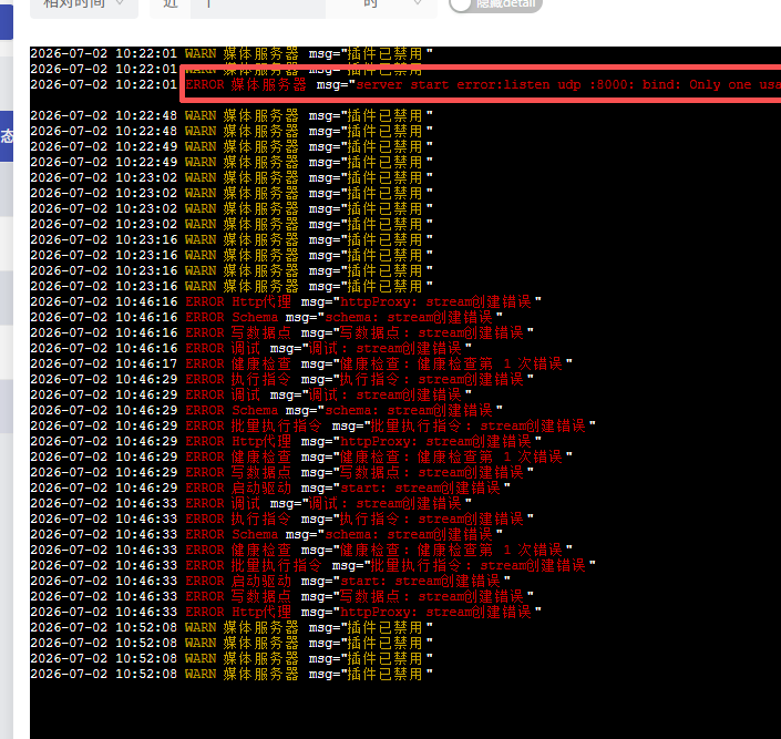

]]></description><link>https://qa.airiot.tech/post/20099</link><guid isPermaLink="true">https://qa.airiot.tech/post/20099</guid><dc:creator><![CDATA[henryyzh]]></dc:creator><pubDate>Thu, 02 Jul 2026 05:54:52 GMT</pubDate></item><item><title><![CDATA[Reply to gb28181驱动全掉了 重启无法解决 on Thu, 02 Jul 2026 05:47:17 GMT]]></title><description><![CDATA[<p dir="auto">看着像是端口被占用了，udp :8000<br />
<img src="/assets/uploads/files/1782971151513-32d967af-2784-401a-b73e-b45887393115-image.png" alt="image.png" class=" img-fluid img-markdown" /></p>
]]></description><link>https://qa.airiot.tech/post/20097</link><guid isPermaLink="true">https://qa.airiot.tech/post/20097</guid><dc:creator><![CDATA[hp]]></dc:creator><pubDate>Thu, 02 Jul 2026 05:47:17 GMT</pubDate></item><item><title><![CDATA[Reply to gb28181驱动全掉了 重启无法解决 on Thu, 02 Jul 2026 05:35:09 GMT]]></title><description><![CDATA[<p dir="auto"><a class="plugin-mentions-user plugin-mentions-a" href="https://qa.airiot.tech/uid/213">@henryyzh</a> 看下驱动日志</p>
