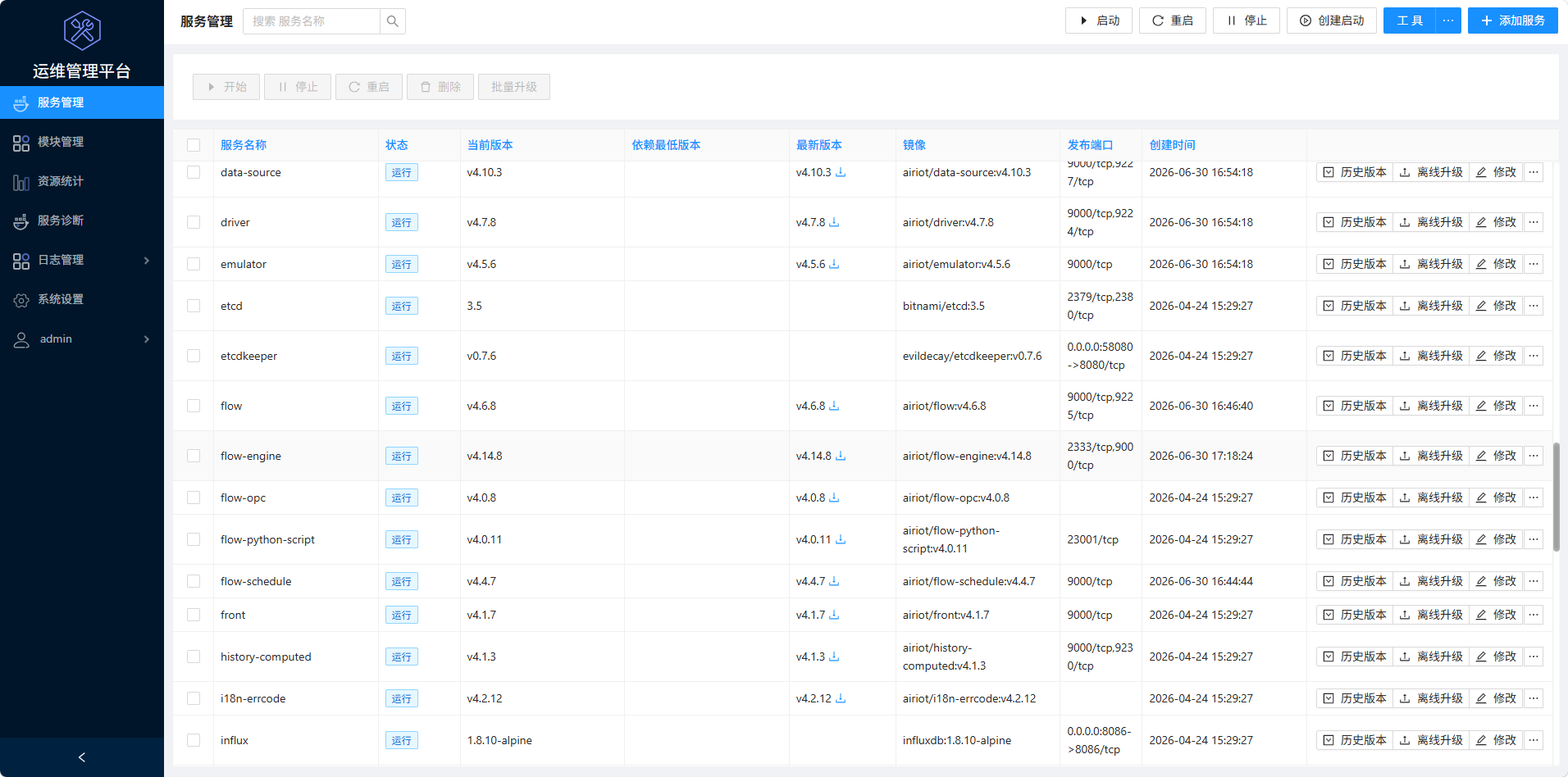

<?xml version="1.0" encoding="UTF-8"?><rss xmlns:dc="http://purl.org/dc/elements/1.1/" xmlns:content="http://purl.org/rss/1.0/modules/content/" xmlns:atom="http://www.w3.org/2005/Atom" version="2.0"><channel><title><![CDATA[flow-engine v4.14.8更新之后会因为缺少文件夹报错]]></title><description><![CDATA[<p dir="auto">flow-engine v4.14.8更新之后会因为缺少文件夹报错错，我手动解决了，但这需要反馈一下。<br />
"ZoneInfo": "/app/configs/zoneinfo.zip"<br />

�time=2026-06-30T17:01:24.089+08:00 level=ERROR msg=服务启动失败 tag=<strong>main</strong> logType=<strong>syslog</strong> service=flow-engine detail="lstat /app/configs/locale: no such file or directory"</p>
<p dir="auto"><img src="/assets/uploads/files/1782811415102-5ef18c67-f3a0-4a03-9270-ad270a986cdc-image.png" alt="5ef18c67-f3a0-4a03-9270-ad270a986cdc-image.png" class=" img-fluid img-markdown" /></p>
