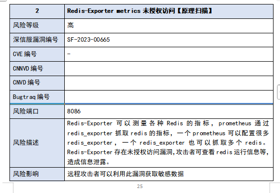

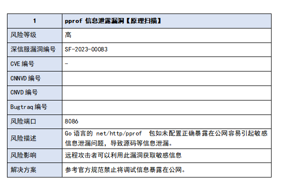

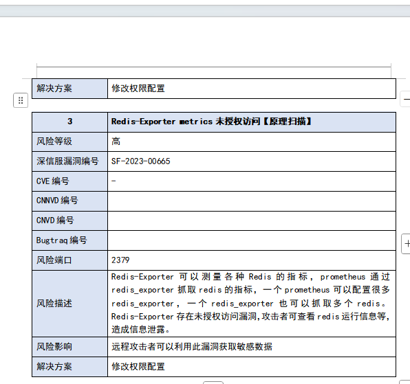

<?xml version="1.0" encoding="UTF-8"?><rss xmlns:dc="http://purl.org/dc/elements/1.1/" xmlns:content="http://purl.org/rss/1.0/modules/content/" xmlns:atom="http://www.w3.org/2005/Atom" version="2.0"><channel><title><![CDATA[客户使用深信服系统对平台进行漏洞扫描出现一下漏洞，需要怎样处理]]></title><description><![CDATA[<p dir="auto"><img src="/assets/uploads/files/1779785450591-15b319bc-e33a-4b44-8a01-91e4e298e341-image.png" alt="15b319bc-e33a-4b44-8a01-91e4e298e341-image.png" class=" img-fluid img-markdown" /> <img src="/assets/uploads/files/1779785466681-3a636501-0888-4103-a384-4dde80f8b124-image.png" alt="3a636501-0888-4103-a384-4dde80f8b124-image.png" class=" img-fluid img-markdown" /> <img src="/assets/uploads/files/1779785486956-86129382-62b5-4d86-ab33-1d3a08ef2f45-image.png" alt="86129382-62b5-4d86-ab33-1d3a08ef2f45-image.png" class=" img-fluid img-markdown" /> <a class="plugin-mentions-user plugin-mentions-a" href="https://qa.airiot.tech/uid/4">@核桃酥</a></p>

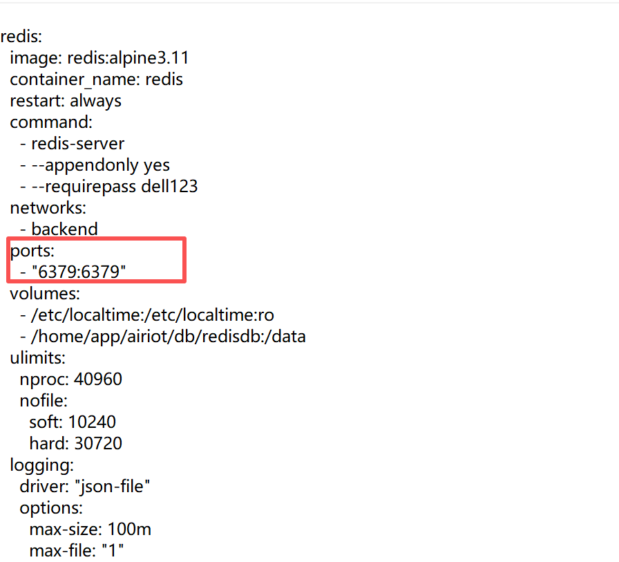

<img src="/assets/uploads/files/1779863282183-c5b0e4c3-e5cd-4e34-a269-6d7dbac99808-image.png" alt="image.png" class=" img-fluid img-markdown" /></p>
