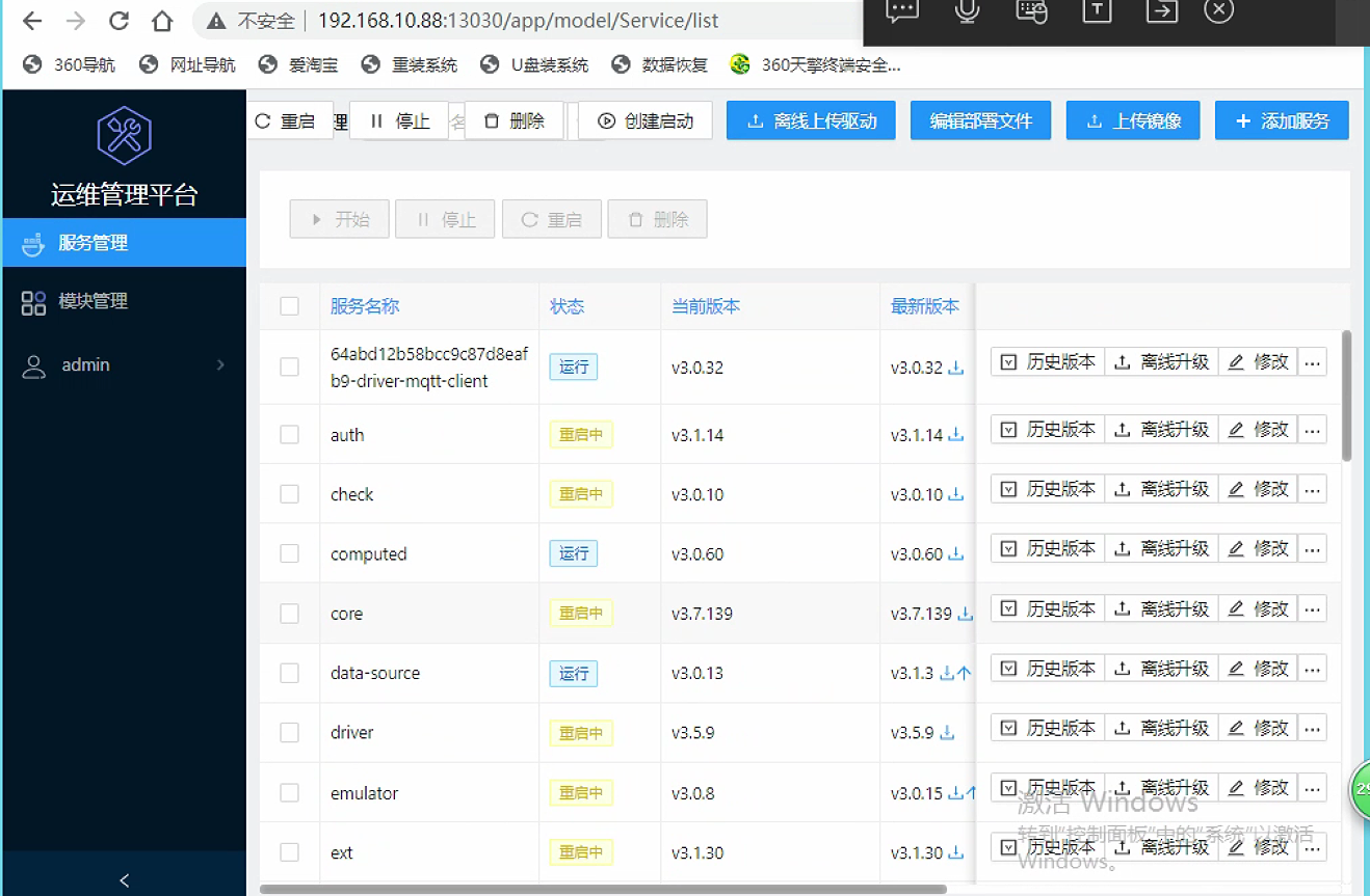

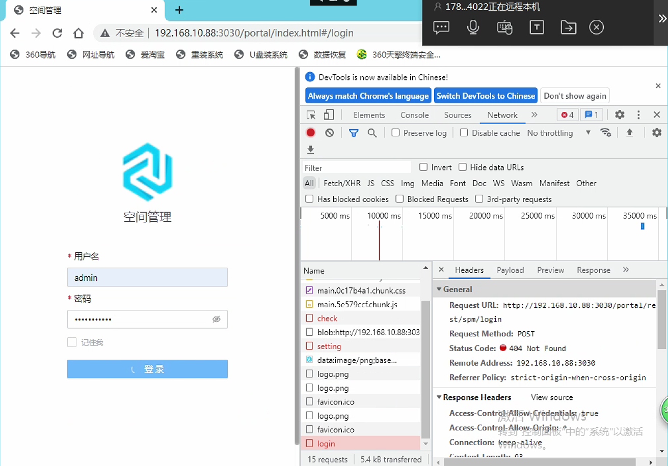

<?xml version="1.0" encoding="UTF-8"?><rss xmlns:dc="http://purl.org/dc/elements/1.1/" xmlns:content="http://purl.org/rss/1.0/modules/content/" xmlns:atom="http://www.w3.org/2005/Atom" version="2.0"><channel><title><![CDATA[airIot 3.0平台登录失败，无法访问]]></title><description><![CDATA[<p dir="auto">平台登录失败，运维平台登录查看大部分服务均处于重启中状态，无法变成运行状态，查看日志显示如 redsi客户端连接失败，webSocket服务连接失败等错误日志。怎么解决？<br />
<img src="/assets/uploads/files/1779346396573-f146020e-8bf5-421f-82a6-52457904d8ea-c79ae7fb-4538-4b3d-aad3-c36011005bb2.png" alt="f146020e-8bf5-421f-82a6-52457904d8ea-c79ae7fb-4538-4b3d-aad3-c36011005bb2.png" class=" img-fluid img-markdown" /><br />
<img src="/assets/uploads/files/1779346664915-9df92489-c629-4090-bb49-4e8698c3777e-image.png" alt="9df92489-c629-4090-bb49-4e8698c3777e-image.png" class=" img-fluid img-markdown" /></p>

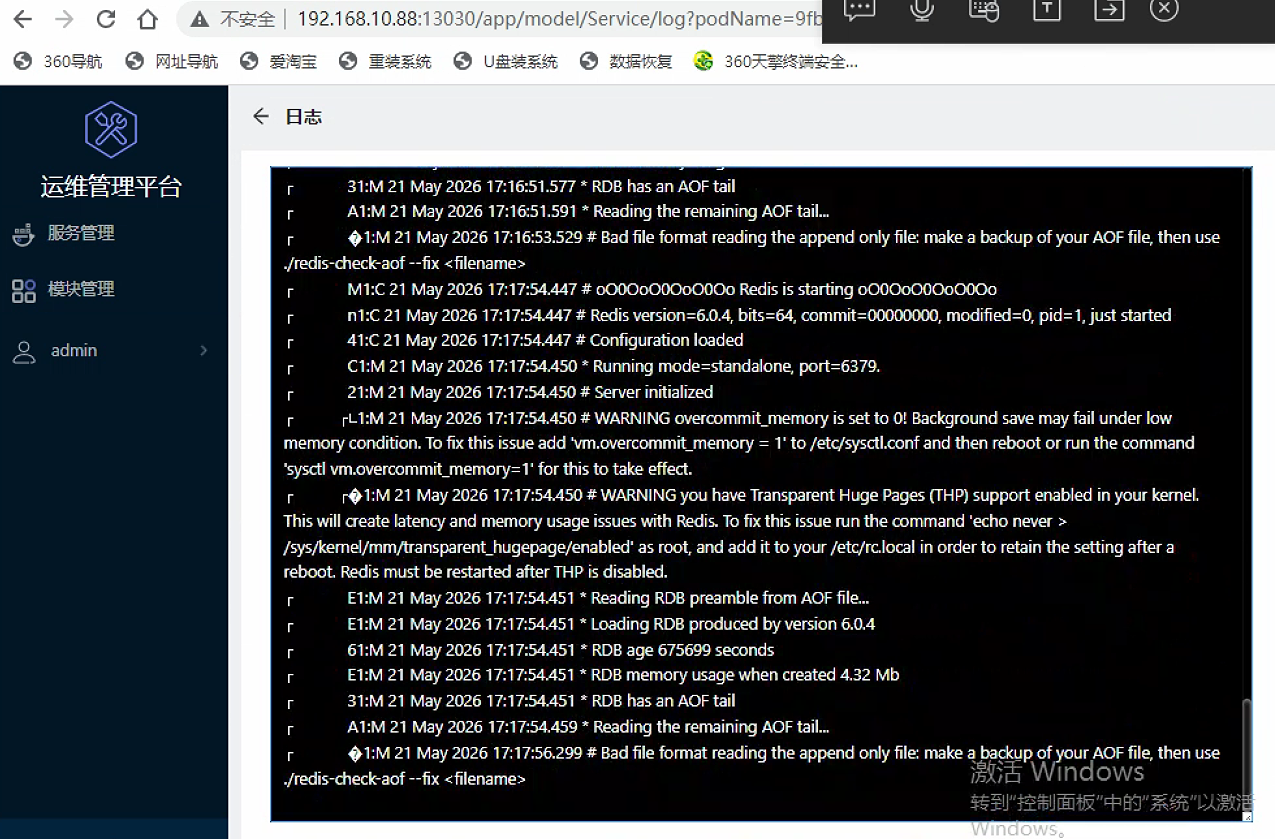

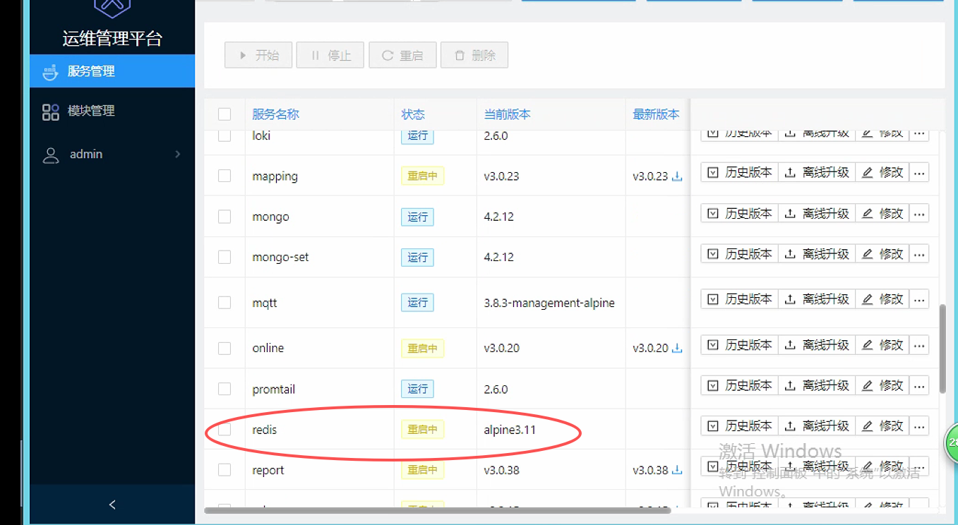

<p dir="auto"><img src="/assets/uploads/files/1779355048981-4711a36f-a6c6-4f33-be31-91e1c0cb8475-f039f23f-9477-4cdc-a880-c5498e761bbd.png" alt="f039f23f-9477-4cdc-a880-c5498e761bbd.png" class=" img-fluid img-markdown" /></p>
<p dir="auto"><img src="/assets/uploads/files/1779355074074-352ef36c-737c-45fa-8b2c-8f808a70b29c-6abce0d7-8ee6-4096-8e76-0467f3a9738a.png" alt="6abce0d7-8ee6-4096-8e76-0467f3a9738a.png" class=" img-fluid img-markdown" /></p>

]]></description><link>https://qa.airiot.tech/post/19811</link><guid isPermaLink="true">https://qa.airiot.tech/post/19811</guid><dc:creator><![CDATA[核桃酥]]></dc:creator><pubDate>Thu, 21 May 2026 09:01:28 GMT</pubDate></item><item><title><![CDATA[Reply to airIot 3.0平台登录失败，无法访问 on Thu, 21 May 2026 06:59:30 GMT]]></title><description><![CDATA[<p dir="auto"><img src="/assets/uploads/files/1779346765435-609ea25a-95c1-45ab-919b-8980a6ca1375-image.png" alt="image.png" class=" img-fluid img-markdown" /></p>

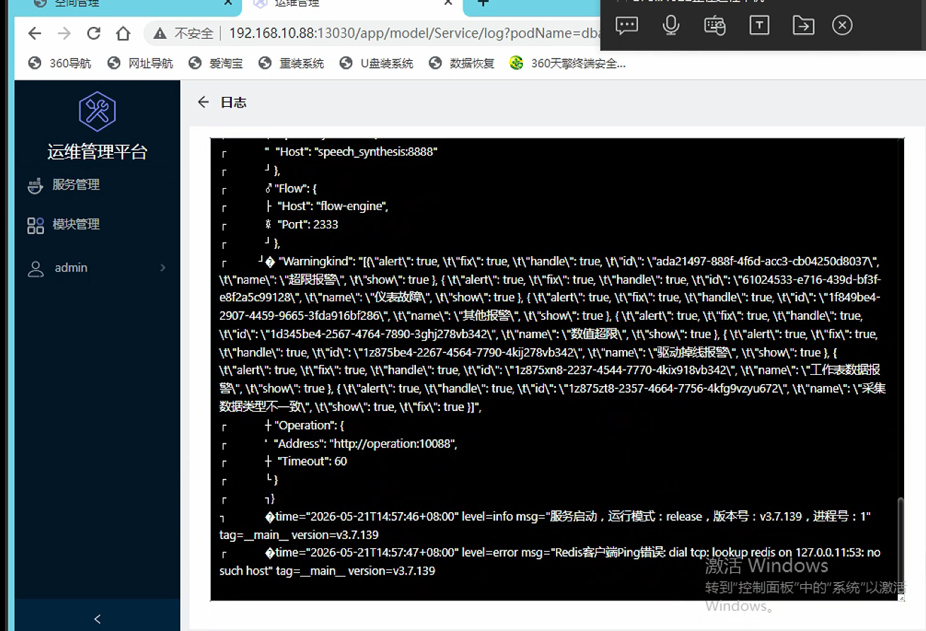

]]></description><link>https://qa.airiot.tech/post/19810</link><guid isPermaLink="true">https://qa.airiot.tech/post/19810</guid><dc:creator><![CDATA[wdgk_wxj]]></dc:creator><pubDate>Thu, 21 May 2026 06:59:30 GMT</pubDate></item></channel></rss>
