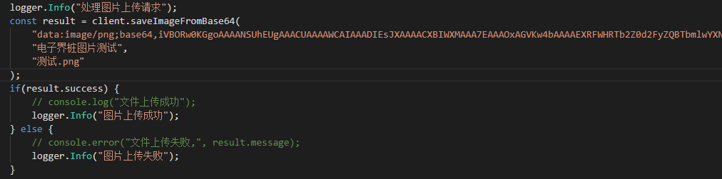

<?xml version="1.0" encoding="UTF-8"?><rss xmlns:dc="http://purl.org/dc/elements/1.1/" xmlns:content="http://purl.org/rss/1.0/modules/content/" xmlns:atom="http://www.w3.org/2005/Atom" version="2.0"><channel><title><![CDATA[http-server驱动，数据处理脚本调用saveImageFromBase64接口报错问题]]></title><description><![CDATA[<p dir="auto">数据处理脚本中调用saveImageFromBase64接口：<br />
<img src="/assets/uploads/files/1778903637630-cb9c0a87-7fb5-44b0-aa60-cee2877e4b12-image.png" alt="cb9c0a87-7fb5-44b0-aa60-cee2877e4b12-image.png" class=" img-fluid img-markdown" /></p>

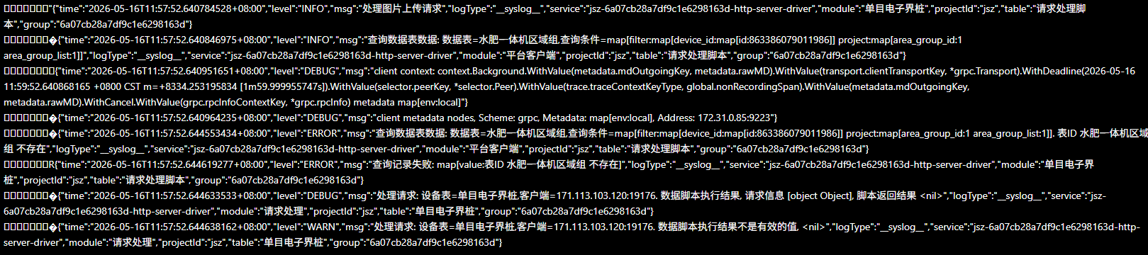

]]></description><link>https://qa.airiot.tech/topic/2737/http-server驱动-数据处理脚本调用saveimagefrombase64接口报错问题</link><generator>RSS for Node</generator><lastBuildDate>Sun, 17 May 2026 05:17:24 GMT</lastBuildDate><atom:link href="https://qa.airiot.tech/topic/2737.rss" rel="self" type="application/rss+xml"/><pubDate>Sat, 16 May 2026 03:55:28 GMT</pubDate><ttl>60</ttl><item><title><![CDATA[Reply to http-server驱动，数据处理脚本调用saveImageFromBase64接口报错问题 on Sat, 16 May 2026 03:58:41 GMT]]></title><description><![CDATA[<p dir="auto">尝试调用其他接口，可以正常执行</p>
<p dir="auto"><img src="/assets/uploads/files/1778903843303-ec3b5edc-eab8-4961-9273-c33718edbcd4-image.png" alt="image.png" class=" img-fluid img-markdown" /><br />
查询流程正常<br />
<img src="/assets/uploads/files/1778903896587-9998e9b9-4083-43fe-bd0b-d2a10c1ebbb3-image.png" alt="9998e9b9-4083-43fe-bd0b-d2a10c1ebbb3-image.png" class=" img-fluid img-markdown" /></p>
