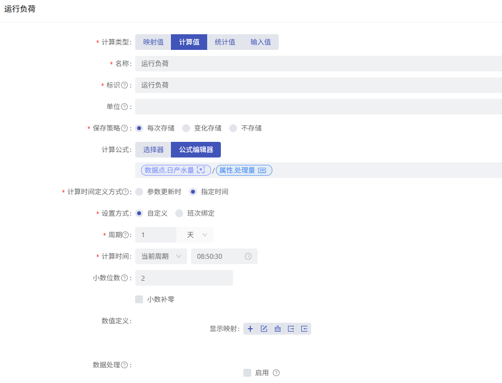

<?xml version="1.0" encoding="UTF-8"?><rss xmlns:dc="http://purl.org/dc/elements/1.1/" xmlns:content="http://purl.org/rss/1.0/modules/content/" xmlns:atom="http://www.w3.org/2005/Atom" version="2.0"><channel><title><![CDATA[计算节点报错]]></title><description><![CDATA[<p dir="auto"><img src="/assets/uploads/files/1778461043646-7e75460f-3534-4fbf-a3ea-79b294cd1d29-image.png" alt="7e75460f-3534-4fbf-a3ea-79b294cd1d29-image.png" class=" img-fluid img-markdown" /><br />

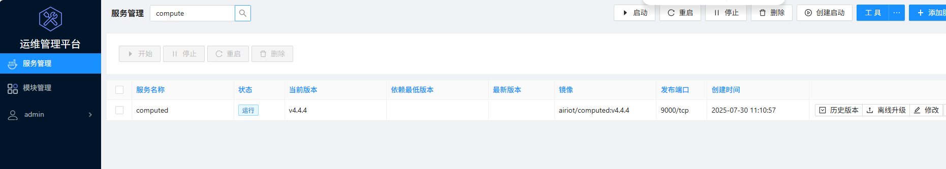

<img src="/assets/uploads/files/1778461060921-5b371329-0a5f-484e-95b4-b410f4e36e9b-image.png" alt="5b371329-0a5f-484e-95b4-b410f4e36e9b-image.png" class=" img-fluid img-markdown" /><br />

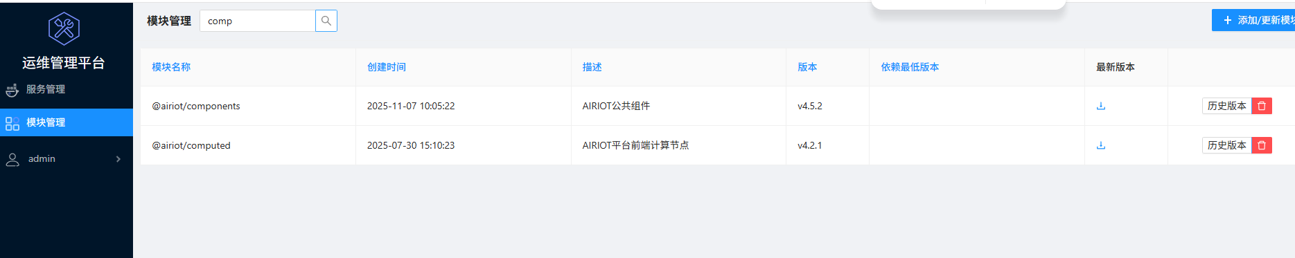

<img src="/assets/uploads/files/1778461100290-815d875f-9a39-4c3e-aa98-e679ee6c85a0-image.png" alt="815d875f-9a39-4c3e-aa98-e679ee6c85a0-image.png" class=" img-fluid img-markdown" /><br />

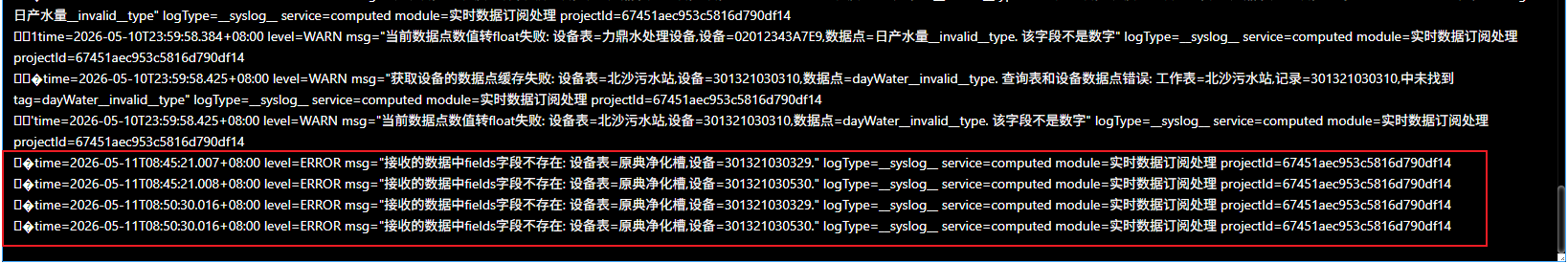

<img src="/assets/uploads/files/1778461128094-00524db8-68b1-44f0-b655-7f92cef31e01-image.png" alt="00524db8-68b1-44f0-b655-7f92cef31e01-image.png" class=" img-fluid img-markdown" /></p>

]]></description><link>https://qa.airiot.tech/post/19753</link><guid isPermaLink="true">https://qa.airiot.tech/post/19753</guid><dc:creator><![CDATA[核桃酥]]></dc:creator><pubDate>Mon, 11 May 2026 07:18:59 GMT</pubDate></item></channel></rss>
