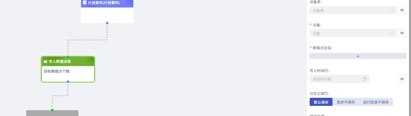

<img src="/assets/uploads/files/1776848857653-4536efd0-3141-4515-9f11-af99b82ff50a-image.png" alt="image.png" class=" img-fluid img-markdown" /></p>
