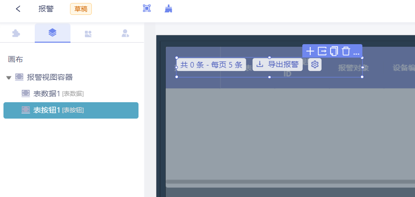

<?xml version="1.0" encoding="UTF-8"?><rss xmlns:dc="http://purl.org/dc/elements/1.1/" xmlns:content="http://purl.org/rss/1.0/modules/content/" xmlns:atom="http://www.w3.org/2005/Atom" version="2.0"><channel><title><![CDATA[报警信息能够像报表那样导出吗]]></title><description><![CDATA[<p dir="auto">不是在中台导出 是像报表能在前台那样有一个导出按钮</p>
]]></description><link>https://qa.airiot.tech/topic/2044/报警信息能够像报表那样导出吗</link><generator>RSS for Node</generator><lastBuildDate>Wed, 14 Oct 2026 00:39:52 GMT</lastBuildDate><atom:link href="https://qa.airiot.tech/topic/2044.rss" rel="self" type="application/rss+xml"/><pubDate>Mon, 26 May 2025 04:43:48 GMT</pubDate><ttl>60</ttl><item><title><![CDATA[Reply to 报警信息能够像报表那样导出吗 on Mon, 26 May 2025 06:19:05 GMT]]></title><description><![CDATA[<p dir="auto"><img src="/assets/uploads/files/1748240323682-29d58ee1-5f03-42bc-af9e-98507042f16a-image.png" alt="image.png" class=" img-fluid img-markdown" />画面里这样做一个画面放前台也可以</p>
